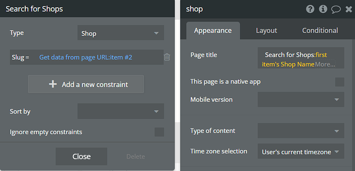

You could do it similar to this.
Don’t mind the small nuance
Instead of page title use it for your data source
wow so i need to search for the slug in the url in order to display that post.
Sure do!
Here’s a more detailed explanation about slugs
https://manual.bubble.io/help-guides/structuring-an-application/page-slugs
