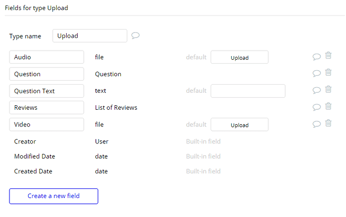

I have tried two ways:
(1) I created a Question field on the Upload data type that is a reference to the Question data type.
(2) I created a Question Text field on the Upload data type that is a simple text field.

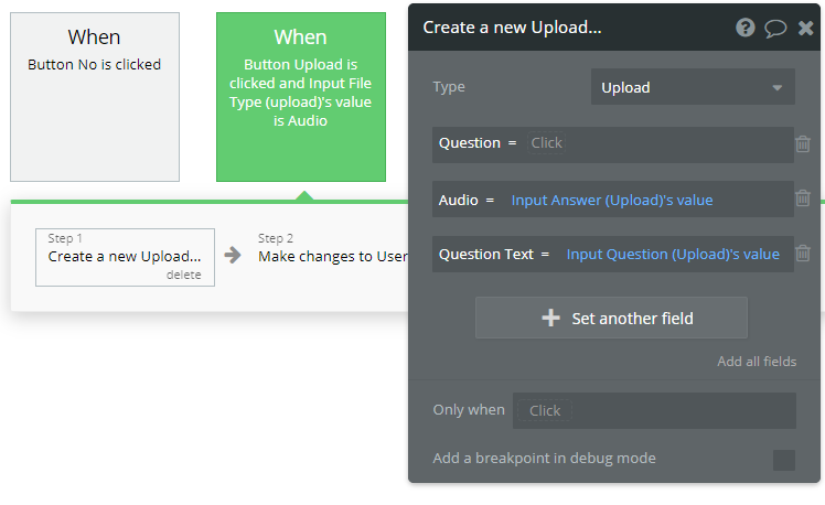

For approach (1) I can’t find any combination of inputs that works. I’m told “Input Question (Upload)” - the name of the dropdown field - is an incompatible type.
And for approach (2) I’ve got something that seems it should work - “Input Question (Upload)'s value” - but when a new Upload is created the Question Text field is blank.
Could be your privacy rules if you’ve set any up? Put your app in debug mode and walk step by step. Click on the Question Text that’s being set to try to understand why it’s getting saved as blank.
I need to get into the habit of inspecting / debugging when I run into trouble - still new to Bubble.
Using the debugger I realized the Question Text approach is working. I have two workflows depending upon whether the user uploads audio or video. I forgot to add the Question Text field to the video workflow which I used for testing. Once I added it, everything worked.

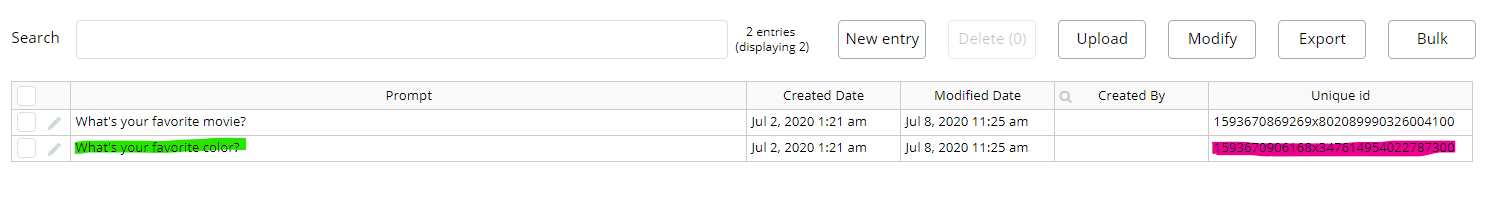

Sorry the example wasn’t clear. Question is a data type. Its records populate the dropdown from which the user selects a question.
When I create an Upload record, I’m able to capture a text snapshot of the question selected by the user using the Question Text field (green highlight below).
I cannot figure out how to save the Question ID of the user selected question (pink highlight below). This would allow me to look up the question text so that if the wording of the question were to change the updated question text would show.
When I try to create this relationships I’m told the input field is an “incompatible type” and I don’t see any other options that would allow me to establish that relationship.
It seems like you’re slightly blurring Things, Fields, and Data Types.
Remember, the Question on the Upload Thing is itself a Thing of type Question. It’s not a field. The input question ID that you’re trying to set it to is a text field I think?
With this datastructure, you’ll probably want to create a Question Thing, add the question ID to a field within that Question Thing, and then add that completed Question Thing to the Upload Thing.
OR, kill your Question data type and replace it with a new QuestionID field that has a type of Text so that it matches your text input with the question id.

Now I’m just trying to “add that completed Question Thing to the Upload Thing” by having the ID of the selected question appear in each Upload Things’ Question field.
Again, sorry for the confusion. Here’s some sample data to help clarify:
In the image above, I’ve kept the color scheme the same as in my previous post. I can link green of this post with green of the previous post. I want to be able to link pink with pink but cannot.
