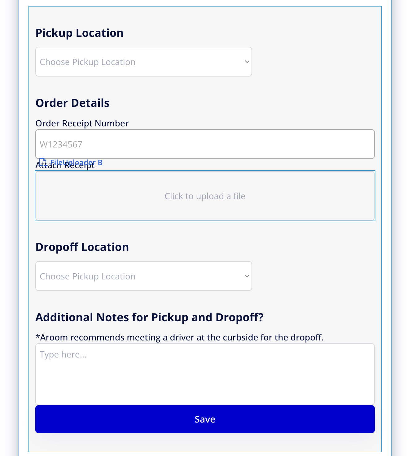

Hello, I am trying to use custom state to temporarily store data. Also, if user fill out the inputs and click “save,” i want those data be displayed in to Repeating Group using custom state. Anyone knows how to do this?
I think I am pretty clear if I only have one input, but having multiple inputs to be shown on RG is difficult for me.
I also don’t want to do “create new thing” since I don’t want this to be stored into DB. If anyone has other solutions, it would be much appreciated! Thanks.

Thank you. I think i got to the custom state for every inputs. However, displaying those in a repeating group seems tricky. Any thoughts?

Yes, I think displaying each inputs tied to each repeating group is possible as displayed above, but I don’t know how to show all the inputs to be show in each cell’s RG. any thoughts?
