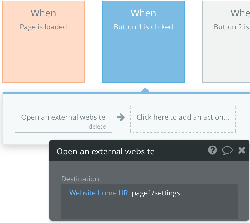

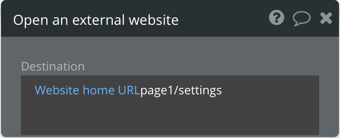

Basically, you can have most of your content in one page, and just use groups to show and hide the content you want. You will need to use “open external website” action
It’s much more convenient then having page1,page2,page3

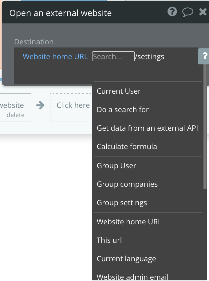

The thing i would like to have here, would be:
instead of writing static value “page1” - a dynamic option “current page name”

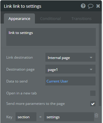

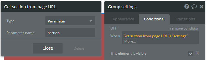

Changing the type of link from external page to internal page, and using url parameters instead of path, seems cleaner to me, and the conditional groups picked up the changed parameter fine. I chose a parameter of “section”, so the links look like:
https://testy11.bubbleapps.io/page1?section=settings
https://testy11.bubbleapps.io/page1?section=charts
This works if its the same data type per page, example for passing the User:
https://testy11.bubbleapps.io/page1/1477032580094x735263108974322700?section=settings
If it is different data per section, it could be passed as another parameter, if it can be expressed as a string.
If you don’t need to use the URL to preserve state, i.e. if you don’t mind that a shared URL or bookmark isn’t specific to the section, it is a lot faster to swap between the groups by setting different values for a custom state instead of following a link to the same page.
