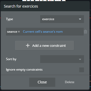

ok I tried :
Capture d'écran 2024-05-21 000406
Capture d'écran 2024-05-21 000621
and it gave me the same value for all :
If you want to display the exercises that is related to this session (that means a repeating group inside another repeating group). The outer repeating group is correct (it is sessions). The inner repeating group though: It will have exercise as the data type and this search as the data source: search for exercises (nom=current cell's session's nom). Then, inner repeating group can display any text: Current Cell's exercise's nom.
