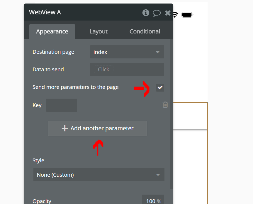

I’d think that what this function is for. ![]()
Using the “Send more parameters to the page”.
Then on the actual page you have the form on, you can do “Get Data from URL”.
I am not 100% sure. but it might be it.
