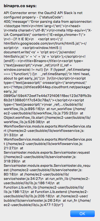

I get this error when I have all of the fields filled. I don’t change the ID and Email Key Paths.
1st, the Slack authorization page pops up allowing me to choose my intended Slack account.
2nd, the same popup then gives me the final option to “Authorize”
3rd, when I click the Authorize button, I’m taken back to my original page and then the error pops up.
for slack replace the access_token with token on plugins tab
I don’t understand what you mean by this sorry.
Specifically for slack, change access_token to token (highlighted)
Ah, I see. I had the “Authentication goes in the header (Bearer)” checked so I didn’t see the “Token name” field. It works thanks! Now how to did you get the profile endpoint?
