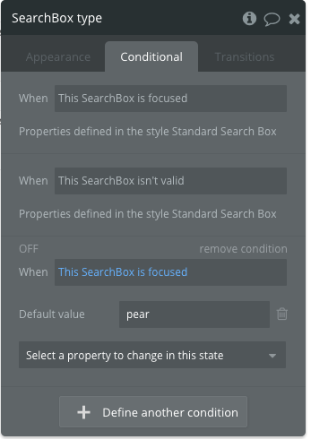

Try this to see if it gets close to what you’re trying to do…
I set a static searchbox with only a few items in it. Then set the conditional for when the box is in focus default value is pear.

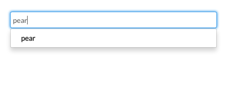

When you click on the input box it automatically populates with the search and you see the dropbox immediately. This only happens once though as the box is now pre-populated.
The user won’t necessary know what fruits are available to choose from, so rather than search for every type of fruit, the dropdown would be available once the searchbox is focused (with no typed text), so the user could scroll through and see the options and select the one they want.
However, if the user did know what they want, then they could simply type in the fruit name, press the down key on their keyboard and press enter.
If I populate the default value with ‘pear’, and the user doesn’t want pear, they would remove the pear text and the dropdown would disappear.
