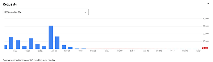

in case anyone comes back to this in the future, i had used the :extract function to pull city & country information from a location field, then displayed the city & country in a repeating group. Each cell in the repeating group used two api calls, with about 500 to 600 records in the repeating group (i.e. 1,000 to 1,200 api calls upon loading the repeating group, every time the rg is loaded). I didnt realize the :extract function relied on an API call to the Geocode API, so my API requests went through the roof when I got a very small amount of traffic. :grimacing:

I’ll be the first to admit I could be wrong on this one, since I feel like I’m trying to reverse engineer the google charges in the dark. I can’t find anything in writing that says the :extract function explicitly uses an API call or it doesnt. But that is the only thing I can come up with that was racking up the geocode API calls (:extract getting used in a repeating group, and displaying geographic addresses instead of text). After I stopped this approach and revised to only show text in my repeating groups (and elsewhere on the site), my geocode API calls dropped >99%. I’m only incurring between 2 to 5 dozen API requests per day, depending on how many jobs are posted per day, how many corporate profiles are created etc vs a previous high of almost 31,000 on one day.
