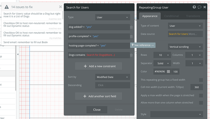

I have a search that shows a repeating group of users where one of the filters is:
show me users whose dog is one of the sizes that my dog get along with.

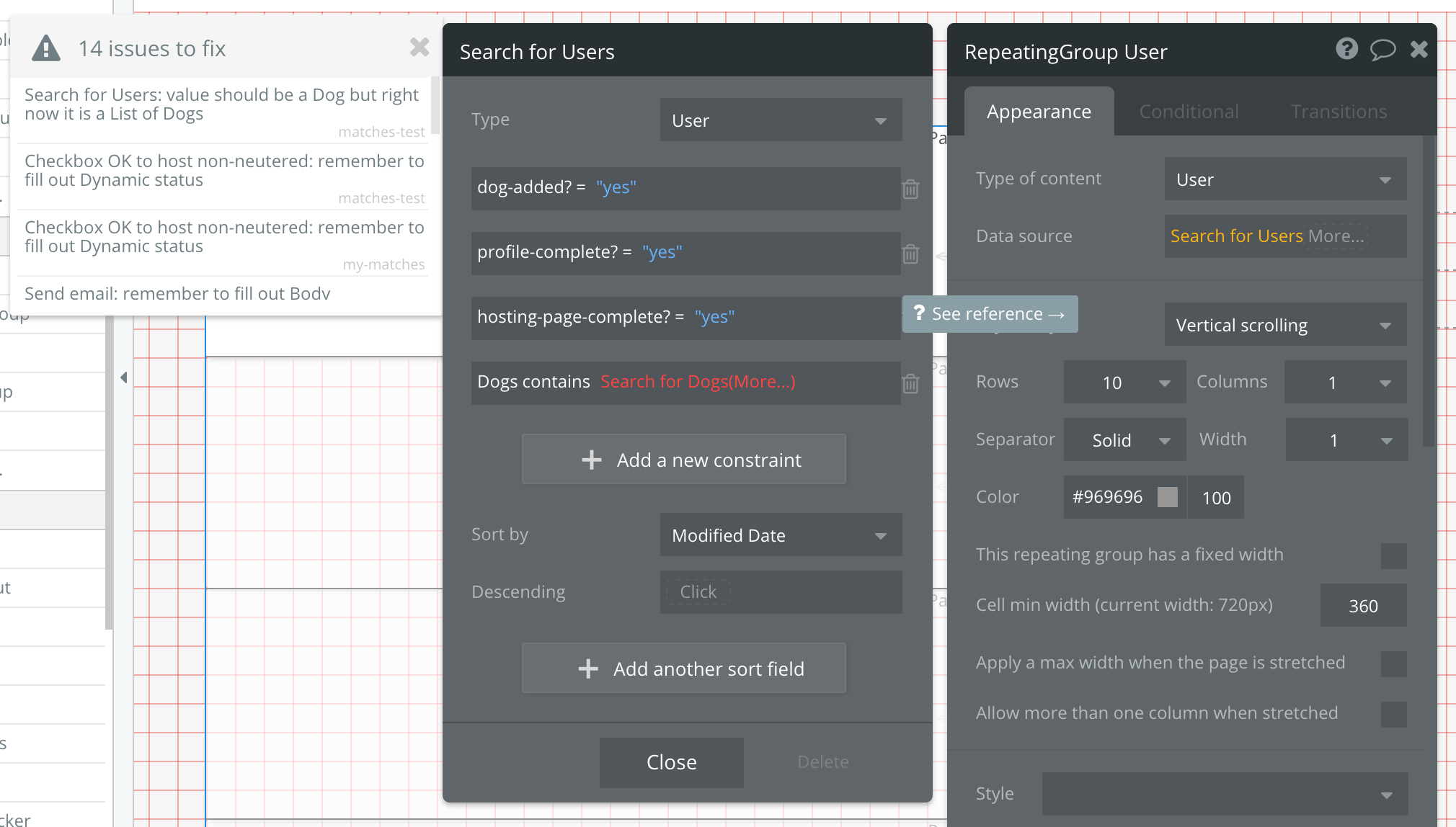

Struggling with this because the ‘do a search for’ call does not allow you to go one layer down into the data. See attached screenshot. Any advice is greatly appreciated. Thanks!

Its a text. However the issue is more that do a search for does not let you dig further down. In this case, since I’m doing a search for users, it does not let me add constraints to properties of the users dog. I.e. User’s dog’s size.
There is probably some trick or workaround here that I just can’t seem to figure out.
What do you see when you press do a search for after dogs? You should see a pop up box that lets you specify a new table and constraints to set.
Yes I’m able to do a search for dogs and set up the constraint. But then the overall repeating group search shows an error. It looks like that constraint is asking for a single ‘Dog’ but if I do that (i.e. just provide the first item), then my search will just show one result.
See attached screenshots. The app has real user data so I can’t share. But I may create a clone with fake data if you or someone else is not able to help.
