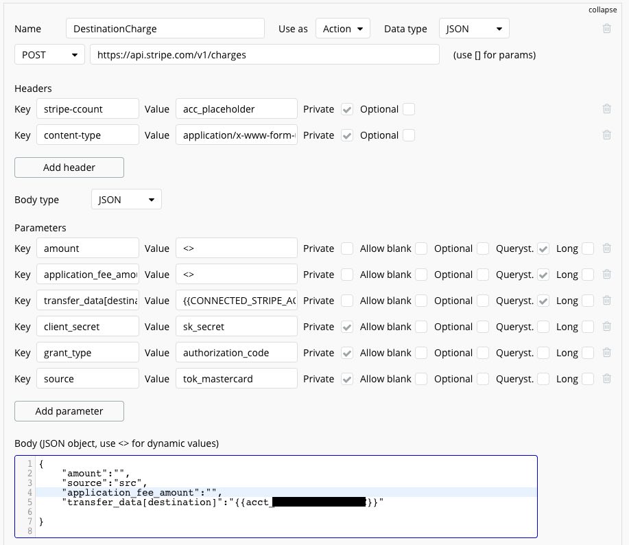

To get it to work I made 2 custom bubble api connectors, one to setup users on stripe connect as sellers and a second to process destination type payments via stripe express.
On my site I charge a small fixed fee to buyers (on top of sale price) this covers stripe connect express fees + I also skim the seller a % of their listed sale price to make a profit and cover stripes transaction % fee.

  4. How do you set up the transfer payment?
I tried to sorta mirror what I saw on the other thread but its not that straight forward. Whats source supposed to be? Have not found good docs on how to fill in the API fields.

So i actually found a simple way to do exactly what I was looking for using the bubble built plugin.
Have the seller register via connect in a separate process. The plugin supports this.
Have the seller put their item up for sale.
When the buyer goes to buy it you show them the cost + a surchage.
Using the bubble “pay via CC” process to have the buyer pay for the item.
Then create a new task called “transfer to seller”. This will now go to the sellers connected account. Set the charge ID to be the charge id of the previous task. And all the right things happen.
