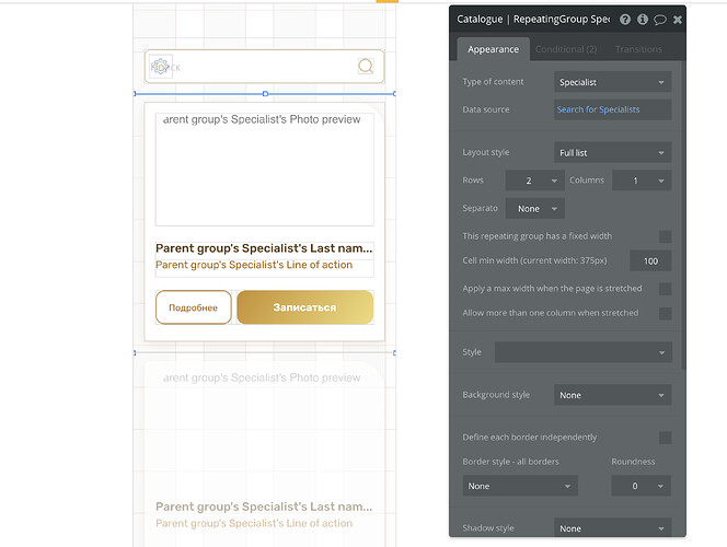

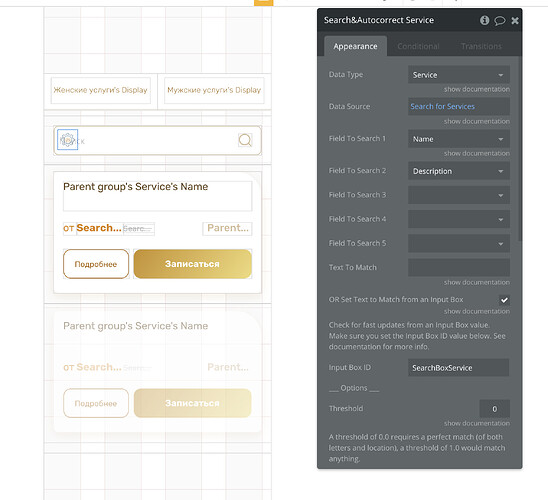

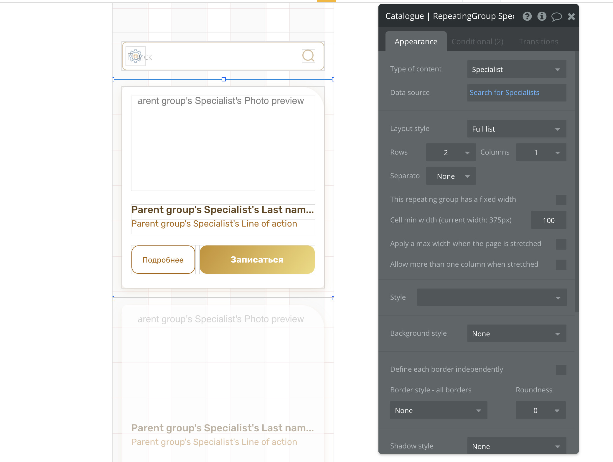

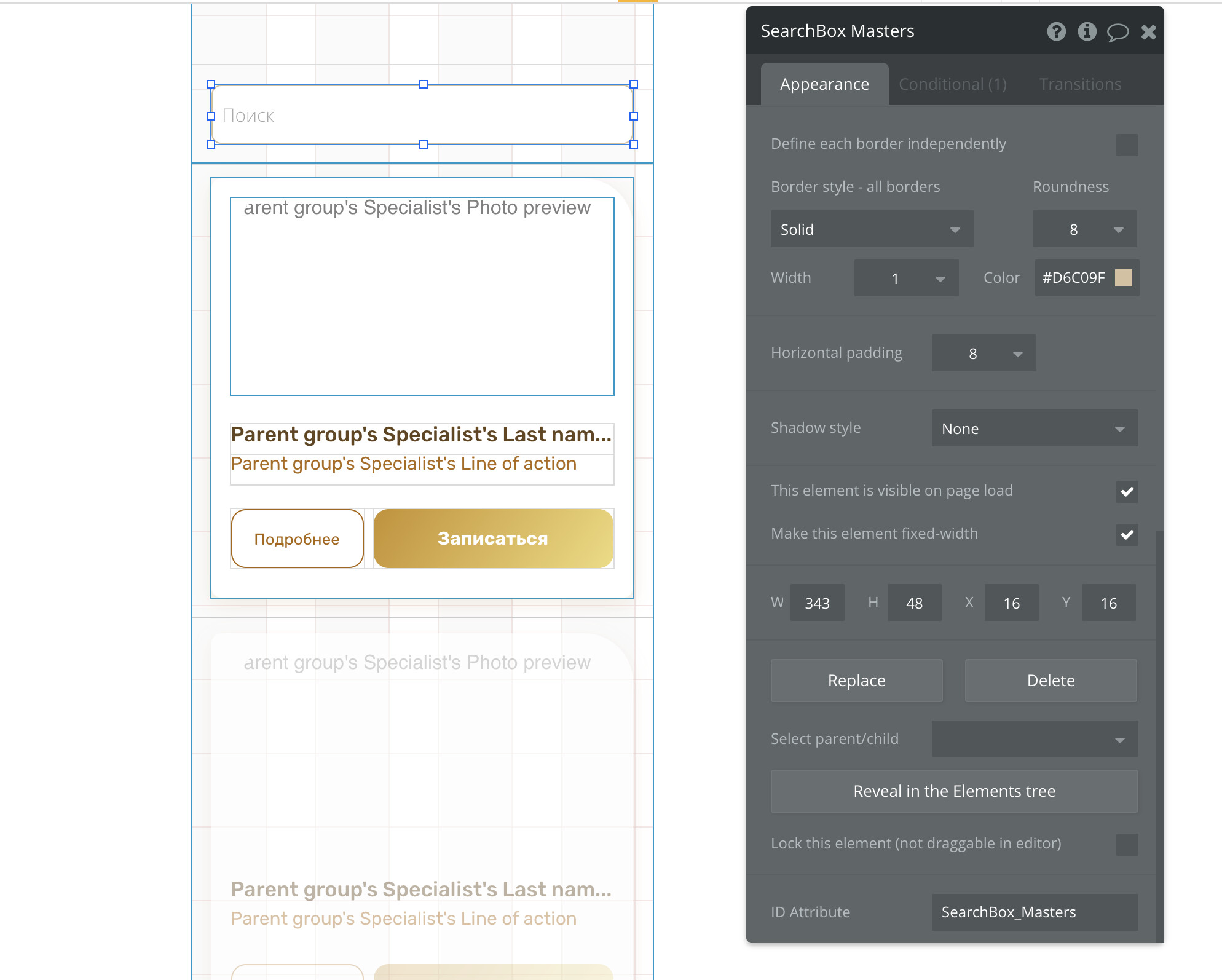

:exploding_head: We are developing a mobile app using a single page where groups are switched. We have placed the search in several groups (there are 3 in total), where we have put unique identifiers that correspond to the RG in which they should display the result. All other settings are set identical to each other. I will attach screenshots of all the search engines below
The problem is only in one group (example 2), and I can’t understand why. The other search engines work correctly. I won’t attach the example of the third search engine because it also works correctly and differs from the others only by its identifier
  1. It works
  2. It doesn’t work
:exploding_head: Also, there is problem number 2. I have your search standing and also have a pop-up window that serves to filter. But if I start filtering, the search stops working. In the opposite direction is similar. You can see the conditional responsible for sorting in rg in the screenshots from the first example
