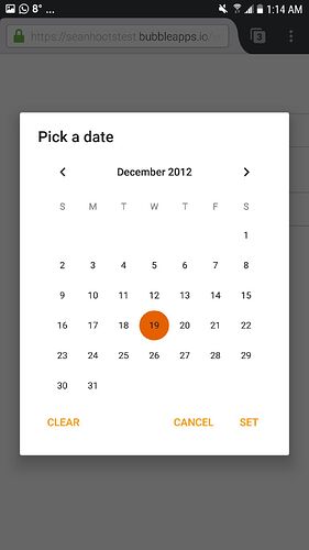

After my frustration with the not so responsive default datepicker in bubble i decided to give this a try.
Here are my tests on different browsers on android and ios.
I only tested the date without time so i used <input type="date">
NB:I was testing only the look and feel and not how to get and use/store the value.
  1. Firefox on Android
    Issue: No year picker
  2. Chrome on Android
    Issue: Looks great but Its not obvious that a user can click on the year to select a different year.
  3. Chrome on ios
    Looks really great
  4. Safari on ios
    Same look and feel as the chrome.
My conclusion: If you’re looking for a very responsive and good looking date and time picker for an ios app in bubble, this is the way to go.
Unless there is a work around the year issues in android i don’t think it will be ideal.
Really hoping bubble will give us a very good looking date picker than the current one which messes up when very small.
