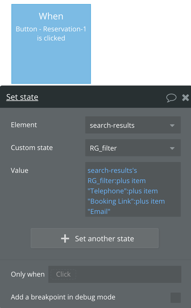

This is the workflow of the filter when it’s clicked:
1st step (RG_filter is the custom state of the page “search-results”):
2nd step (the res filter is suppose to be what’s in the red text box):
I think my issue is in the 2nd step where I’m adjusting the RG based off this new filter. I’ve been stuck on this for a while so really appreciate any help on this! :slight_smile:

Your issue seems to be the setting of the state…if you are using a checkbox to add the ‘type’ individually your addition to the list value stored in the state should be
search-result’s RG_filter:plus item current type
When I use ‘current type’ I am expecting your filters to be in a repeating group with a specific type set to it that is the same that the custom state holding the list is.

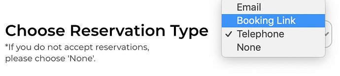

Hi @boston85719, thanks for the quick reply! I’m having store owners choose the ‘type’ via a dropdown:
If I’m using a dropdown, is there a different way to set the state?
If it is a single value as a state, and you use a dropdown, then in your workflows you setup the action based on elements inputs value changed.
For the element select the DropDown holding those types…then use the action to set the state.
The state value will be the dropdowns value.

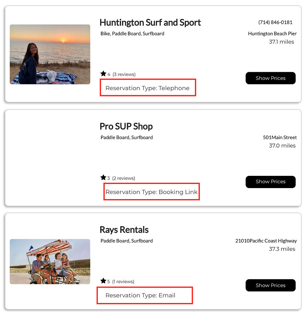

This is what’s seen on the front-end, when users are able to view their search results.
I inserted the store’s reservation type they accept by using this logic in the back-end:
And does that do what you are looking for? I thought the issue was about passing the value selected by a user on one page to another page.
@boston85719 The issue is that the “Accepts Reservations” button doesn’t correctly filter the repeating group to show all the stores that take reservations.
In this picture, I have all my stores accepting reservations and this appears by default. When I click on the “Accepts Reservations”, this repeating group should still be showing these three stores but it is not. It clears out all the stores, so it is not working properly.
