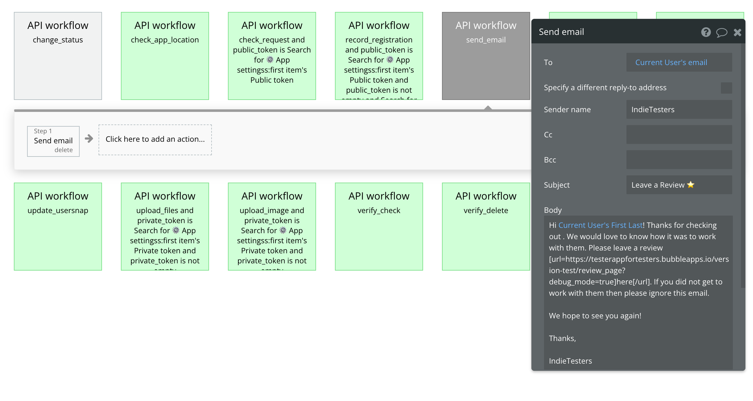

Currently, my app has a review system where after a client picks a person to work with they get an email a few days later asking to review them after they work with their person. I have set up a workflow in Bubble with an API that delivers the email after they hit a button within my app.
The email itself contains hyperlinks to the review page where they can leave a review for the person they worked with. The issue is I cannot figure out how to send the user information through the email so that when they click on that hyperlink in the email they are leaving a review for the person that they worked with. I will attach screenshots below.
This is the workflow to send the email.
This is the API I set up in bubble to actually include the email.

This is the actual email.

What you have to do is, in your workflow, in a step before you send the e-mail, you need to CREATE a new Review. The Review will be empty, you will fill just the User and the Reviewer. Now you can get the Unique_id of this review in the next steps of your workflow to compose the entire URL.
That will be something like this:
www.yoursite.com/review_page/123712983710981231239712
I already saw that your review_page is with the correct data type, so you should be able to access the information of this review anywhere in your page :wink:
