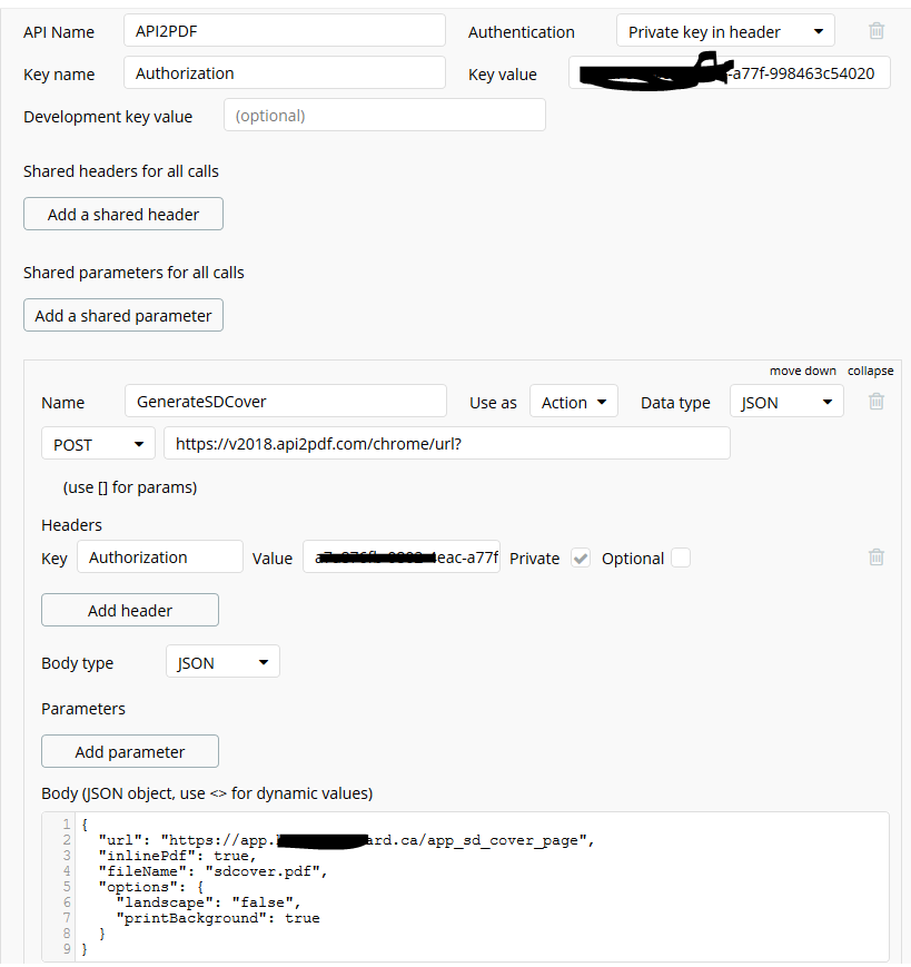

Hello @gnelson
Here is the API setup for sending a URL to API2PDF.com. You will need to set up an account on the website and get an API Key. It’s very easy to do.
You need to set this up in the API Connector Plugin.
On the page I am using, I have a workflow that sends the page to the API once the image is clicked (just to test the function, this won’t be the final design). But basically any button can run this.
Step 1 runs the API.
Step 2 downloads the PDF that was generated.

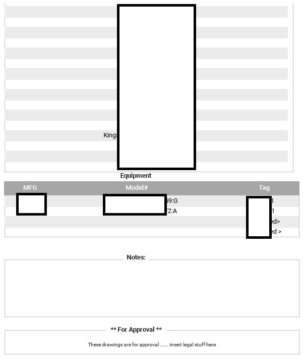

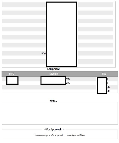

These two pages are what is generated (I added a garbage RG just to have it run into a second page) (sorry for the redaction). I set the page dimensions to what works to ensure a “letter” sized page. The width is 855 (letter size). You will have to test it for 11x17, but it should be double.

I followed your instructions and did generate a pdf, but ended up with a two-page document with the second page empty. Based on what is shown on page one it would actually be a three to four page long document. Is there some other setting I need to use?
Update: I had the page set for portrait. I tried a few things while troubleshooting, and discovered two things. 1. Changing to landscape, for whatever reason, did put data onto page two, but it still only showed the same number of rows. So that got me to thinking… 2. I needed to change the RG settings to Full List. That did the trick.
