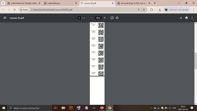

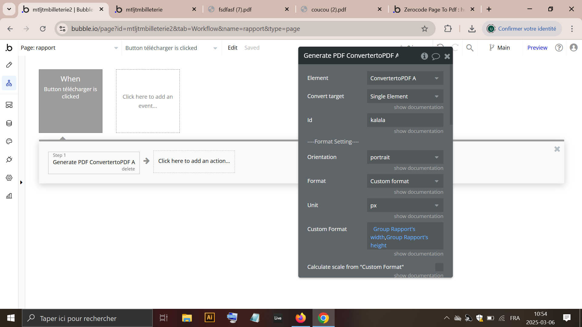

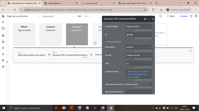

how would you see that in bubble. I mean, the “is loading” is not effective as bubble seems to be “ending” loading at the moment the information is known rather than displayed. How would you implement a feature that automatically scrolls though the entire repeating group ensuring data is fully loaded. Is it possible within bubble ?
Btw I have also found another issue. I use the custom format and set the height of the pdf document with the height of the repeating group. In that case it is 1800 units approximatively. I do the the same with the width which is 361 px.
But this is what I get : a height that is 5 times the sze of the repeating group.
these are my options
and a proof of the siez of the pdf generated
document pdf size : 96 × 86 816 mm (portrait)

As for your second question about the Custom format, the action will retrieve the exact values you specify. To test this, try using static text and observe how it’s displayed. You can also use the step-by-step mode to inspect the action and confirm the exact values being returned.

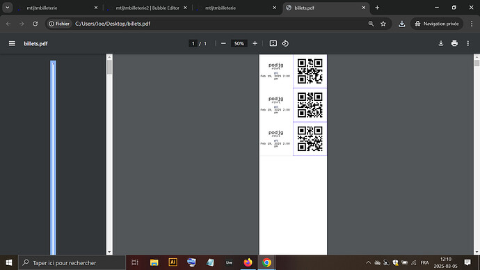

hello, I will double check - but that is the problem. So my pdf file is suppose to be 1800 px but right now it is way bigger.
In bubble, it says the documents has 1900 px of height
thought in reality it brings it to 328123.46457 px
I tried with other height of repeating group and i get the same 328123.46457 px
Thought the width is alrite.

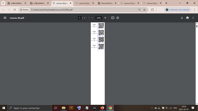

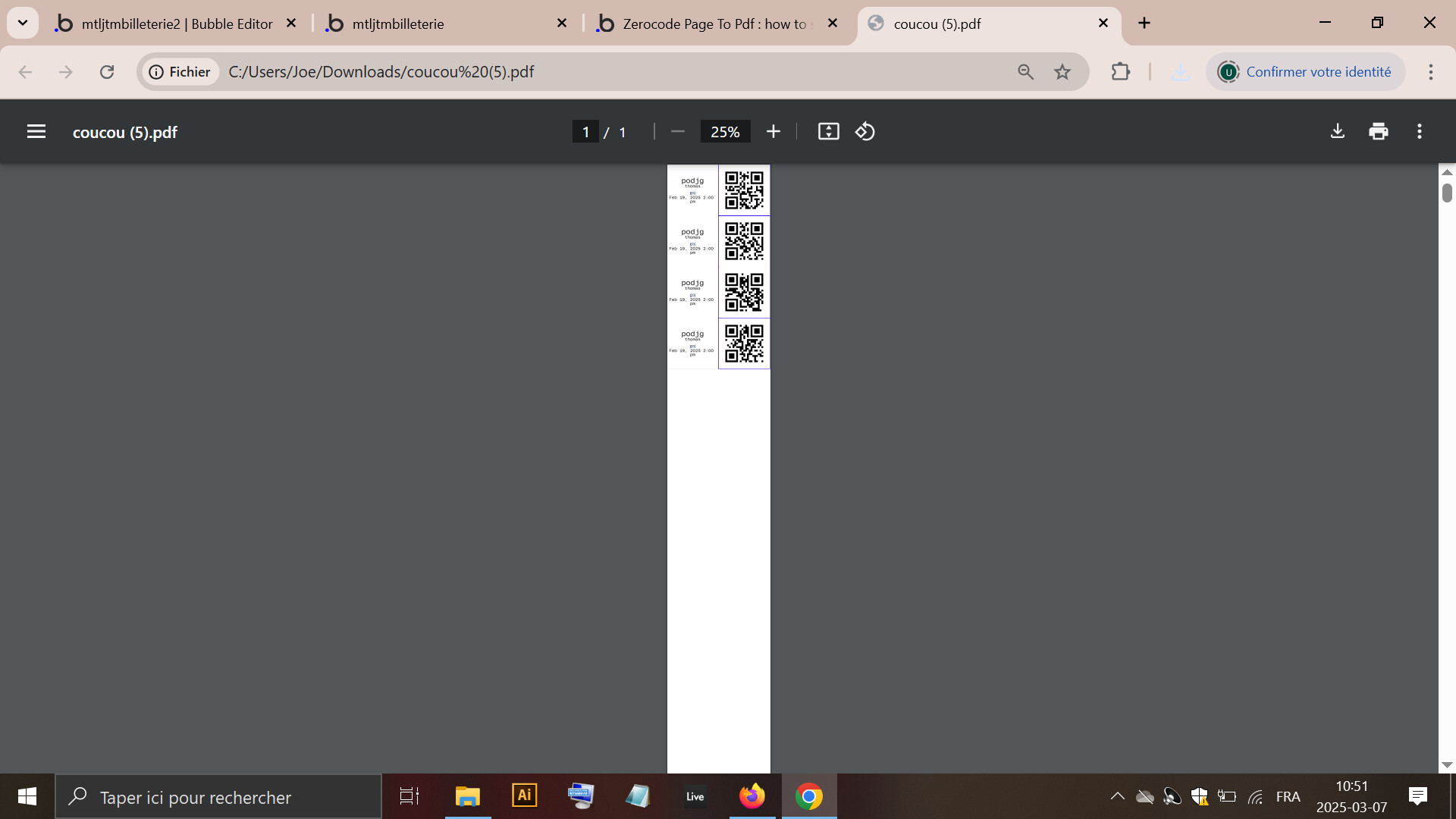

Here is an example
and now look at the document lenght (btw i turned 90 degrees to see how big the lenght is)
all the white is extra that is not suppose to be there and look at the size with the drag table at the bottom
Hello @usinelachine,
Thank you for your message, and apologies for the delayed response over the weekend.
Regarding your concern, it is indeed unusual. We’ve tested further on our end, and each time the height and width displayed correctly, so it’s possible there are other factors within the app influencing the printing CSS.
To investigate this further, could you please add our Support Team email as a collaborator and share the link to your app? This will allow us to examine your settings and replicate the issue on our end. To add our Support Team, follow these steps in your Bubble Editor:
Settings > Collaboration > Add email support@zeroqode.com.
In addition, please provide instructions on how to reproduce the issue, including the page name where the plugin element is located, any relevant groups or repeating groups, the plugin element configuration, and associated workflows. A short description of the steps to follow, as well as any necessary user credentials to log in, will help us troubleshoot effectively. If possible, a short Loom video demonstrating the process would be greatly appreciated.
For your convinience, please feel free to reply in DM.

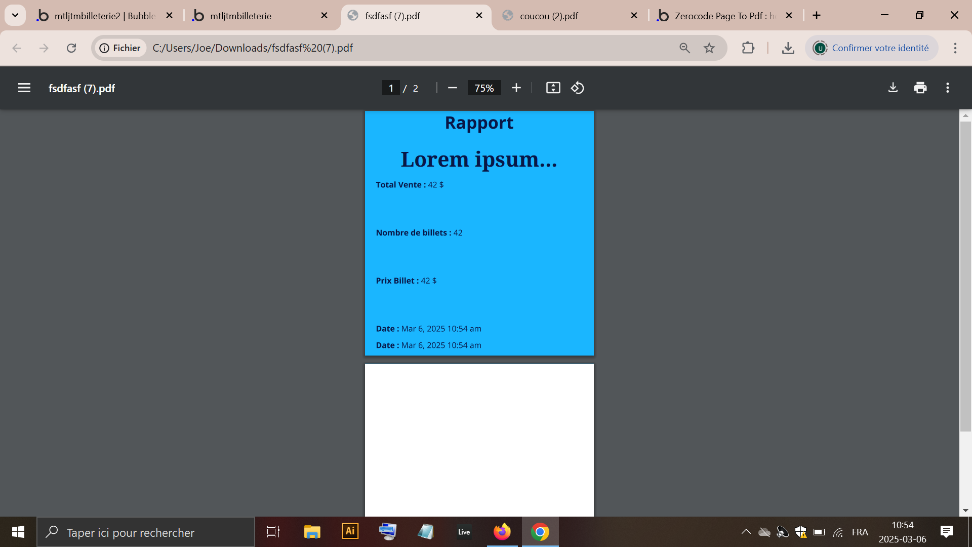

Hello, it is still doing it on my end. I am surprised you managed to make it work. Just to make sure, it is the pdf that is automatically downloaded once you reach the page that is problematic. Here is the page in incognito mode still doing it
by the way, there is a weird new break
I have been recreating the break

hey I know or I bet you are tired of this threed but most of the solution would work if the pdf was too short. I mean, now my problem is that it is incredibly long for no reason while the width is alrite.
The element captured is a Block Id"ed
There is no CSS
I use rendering delay already ; the tickets are being saved in the pdf correctly. There is just a white tray down after that makes the height incredibly long.
this time i put 2000 px
and i still have the same results :
ill install a new browser to see if it still happens.
Btw I can’t fix a “fixed” height, because the client can be up to 10 tickets or simply 1. The document received need to mirror that to look professional.

interestingly, after i put the repeating in a group, even i generate the pdf from the block id (repeating group), now it does not do the infinite white tray.
I will give conclusion after i end up testing it - i still have layout issues
