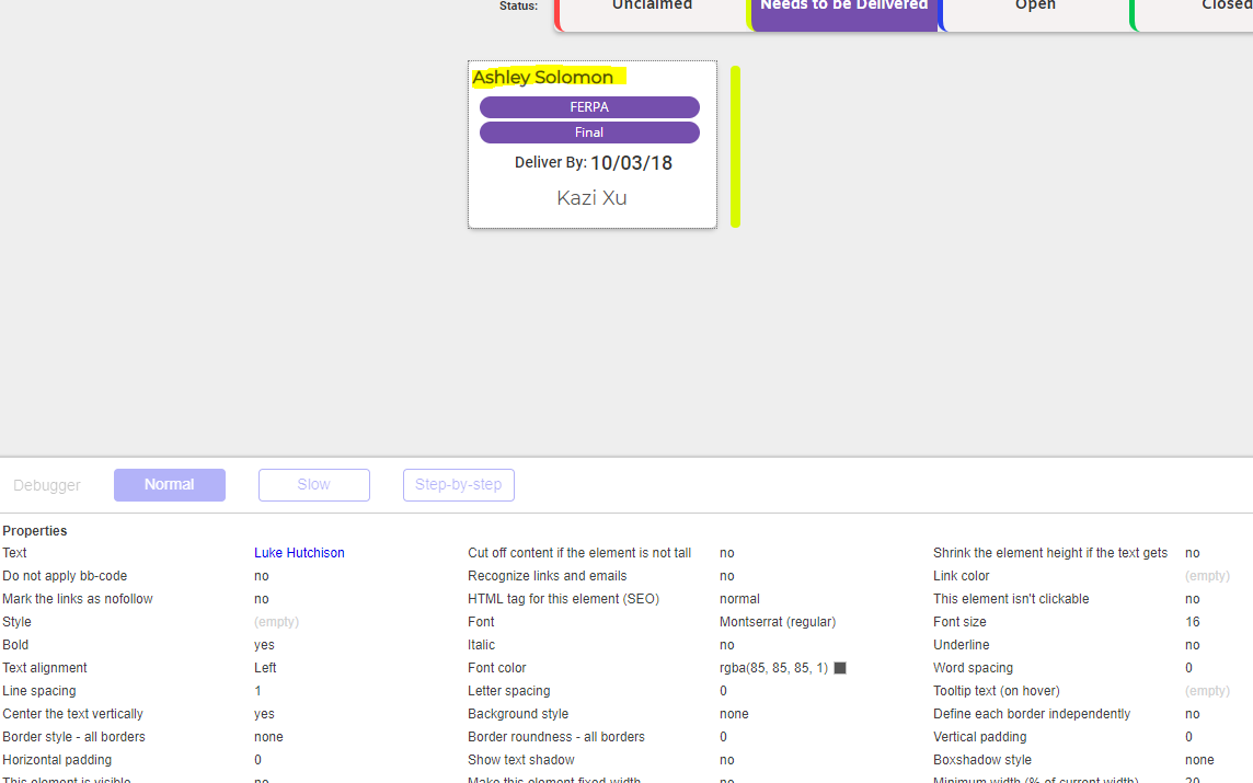

The debugger is showing what the text should say, but the text is not displaying the correct information. How do I fix this? This occurs when I am using my filter to filter my repeating group. I have 4 hidden groups in a repeating group cell. What ever the filter status you select determines which group will be visible. Here is a screenshot.
As you can see, at the bottom in the debugger, the text should be saying “Luke Hutchison”, but it is displaying “Ashley Solomon”.

Have you upgraded your app to the Newest version with the most recent Text element updates?
I had some major bugs with Text elements not showing the text that the Debugger said it should be showing. But they were fixed when I upgraded my app version.
That worked! Thank you.
