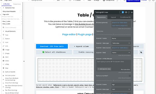

I just bought this and having trouble understanding. I want to assign a Thing to the table, set the columns appropriately, and have it sort.
The way to do this with this element appears to be very complicated. I have to set a source for each column, I have to sort each column for every possible combination, and do so independently and aligned for each column and for the ID.
Is this correct?
Hi @RPSM!
I think this would be very helpful for you (editor of the demo page): Pluginpreview | Bubble Editor
On that page you can exactly see how the table is setup, and yes, just make sure that every list of data is sorted the same way and is the same length as the others:
