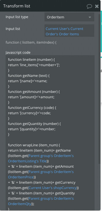

Hi @nicolas_dap ,
Purchased the plugin and trying to use the Create - Payment mode (for many line_items).
I have referred to your Notion doc and I am able to go all the way to checkout but the line items are not passed through. I ran in debug mode and realised the line items were null. I am struggling with the Transform List step. I tried with original transform list JS code in your notion doc but couldn’t get it to work. Tried to manipulate it myself but to no avail as well.
function lineItem (number) {
return ‘line_items[’+number+‘]’;
function getName (text) {
return ‘[name]=’+name;
function getAmount (number) {
return ‘[amount]=’+amount;
function getCurrency (code) {
return ‘[currency]=’+code;
function getQuantity (number) {
return ‘[quantity]=’+number;
function wrapLine (item_num) {
return lineItem (item_num)+ getName (listItem.get(Parent group’s OrderItem’s OrderItemListing’s Title)) + ‘&’ + lineItem (item_num)+ getAmount (listItem.get(Parent group’s OrderItem’s OrderItemPrice)) + ‘&’ + lineItem (item_num)+ getCurrency (listItem.get(Current User’s shopCurrency)) + ‘&’ + lineItem (item_num)+ getQuantity (listItem.get(Parent group’s OrderItem’s OrderItemQty));
return wrapLine (itemIndex);
Hope you’re able to advice and looking forward to hearing from you!
