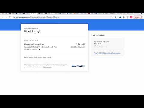

Can you record a screencast of all the process?
Here is the screen recording of all the steps.
Thanks. Your main issue is that you are on free plan and this doesn’t let you expose API endpoint.
Test in a tool like Insomnia or Postman and you will get something like:

Ya you are right. I wrote to Bubble support as well and the issue seems to be that API endpoints do not work on Free plans.
thanks for helping me out here! :slight_smile:
