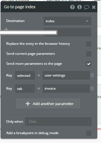

I have a single page app and use the “Go to page” function to navigate between groups but I can’t figure out how to open a link in a new tab?
window.open("https://www.url.com");

sorry, I should have explained… that’s JavaScript… so you need to use a ‘run JavaScript’ action (from the toolbox plugin)

Because you’re trying to open a page called ‘version-test’, which presumably doesn’t exist in your app.
Website Home URL includes the ‘version’… (it also includes the trailing slash…)
So, in your above example you’re trying to open the URL: www.my-app.com/version-test//version-test
… which is not only a page that (presumably) doesn’t exist (unless you do have a page on your app called ‘version-test’), but it also contains a double forward slash in the path which, while it should still work, is not needed and might confuse people…
So, you just want to use window.open("Website home URL?debug_mode=true&selected=user-settings&tab=company")
