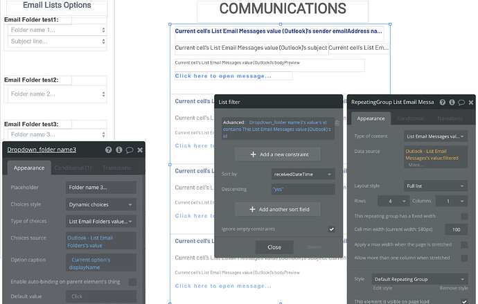

Hi all,
This has really got me puzzled, and I’ve been waiting too long for that aha moment to come. As you can see, to the right I have a repeating group displaying users Outlook email messages. On the left (dropdown folder name 3 contains a list of the users email folders. I can’t seem to configure a solution that connects them both. ( and I’m running out of ideas ) When previewed, the repeating group displays all emails and when filtered by the dropdown folder name 3 they all disappear.

I think your issue is more related to a bad filter setting (I think you are not using the same data “type” to compare… seem one is message id while the other is probably folder id…). Use debug_mode and inspect your settings. Probably check one message id and one folder id.
Your RG is set to a tupe Message while the dropdown is set to a type Folder.
I guess that in message, you probably have an access to the folder id too, just need to use the correct path.

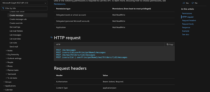

This is the endpoint to create message. You need to check the one to get message (List email message)
In there, you should see a path to the folder ID
I’m on mobile so it’s hard to check myself, but in screenshot, click on “List message”. this is the endpoint. And click on the List mail folders and you will see the one from the List Folders call.
