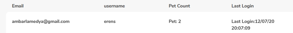

If my users fill a long form or there is a long process in the app, deploying some things may cause them to abandon the app.
So I have been using a simple method on my admin pages for a while to make sure that users are not using the app in the meantime.
First of all, I added a field to the user data type.
ice_screenshot_20200712-232603
I update this field every time they log into the app and repeat this check every 15 seconds.
I add a Repeating Group on the admin page and check who and when it was last online among users.
I have been doing what I need to do about the live version if no one has been online for a while. For example: Deploy some things or check logs.
Since I have noticed the bug in the subject, I have been using this simple solution if I need to switch to the live version to check logs or other things.
Unfortunately, this bug is not a continuous thing and it is very difficult to prove. So I will use such a method for a while.
I hope I could clarify.
