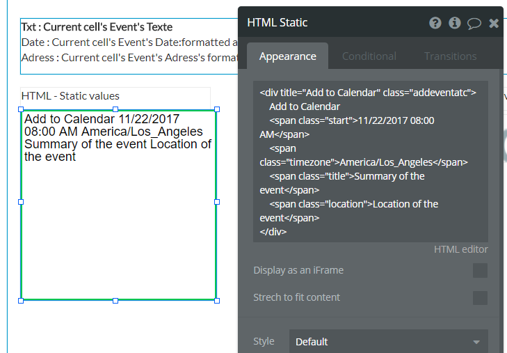

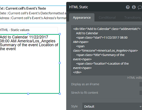

I want to add an Add to Calendar button, but I don’t understand why I get this :
here the demo public app : bebubbletest | Bubble Editor

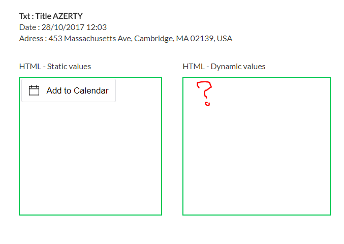

The HTLM element with static values works
but the HTML element with dynamic values doesn’t
Does someone know what’s going on here ?
Thanks for your help

Im wondering if it requires a “date type” as once you add formatted as to the date there it becomes a string.
A stting is needed actually
From the doc : "Start date of the event. Accepts most date/time formats, e.g. 11/22/2017 03:00 PM (12-hour format) or 22-11-2017 15:00 (24-hour format). "

If you take all the html out and leave the dynamic refs, do you see all the data you would expect to see?
yes, with static values it works. I wonder if a refresh of the element isn’t needed after the page as loaded since the button work Async.
