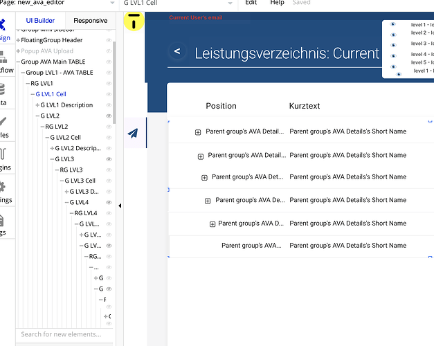

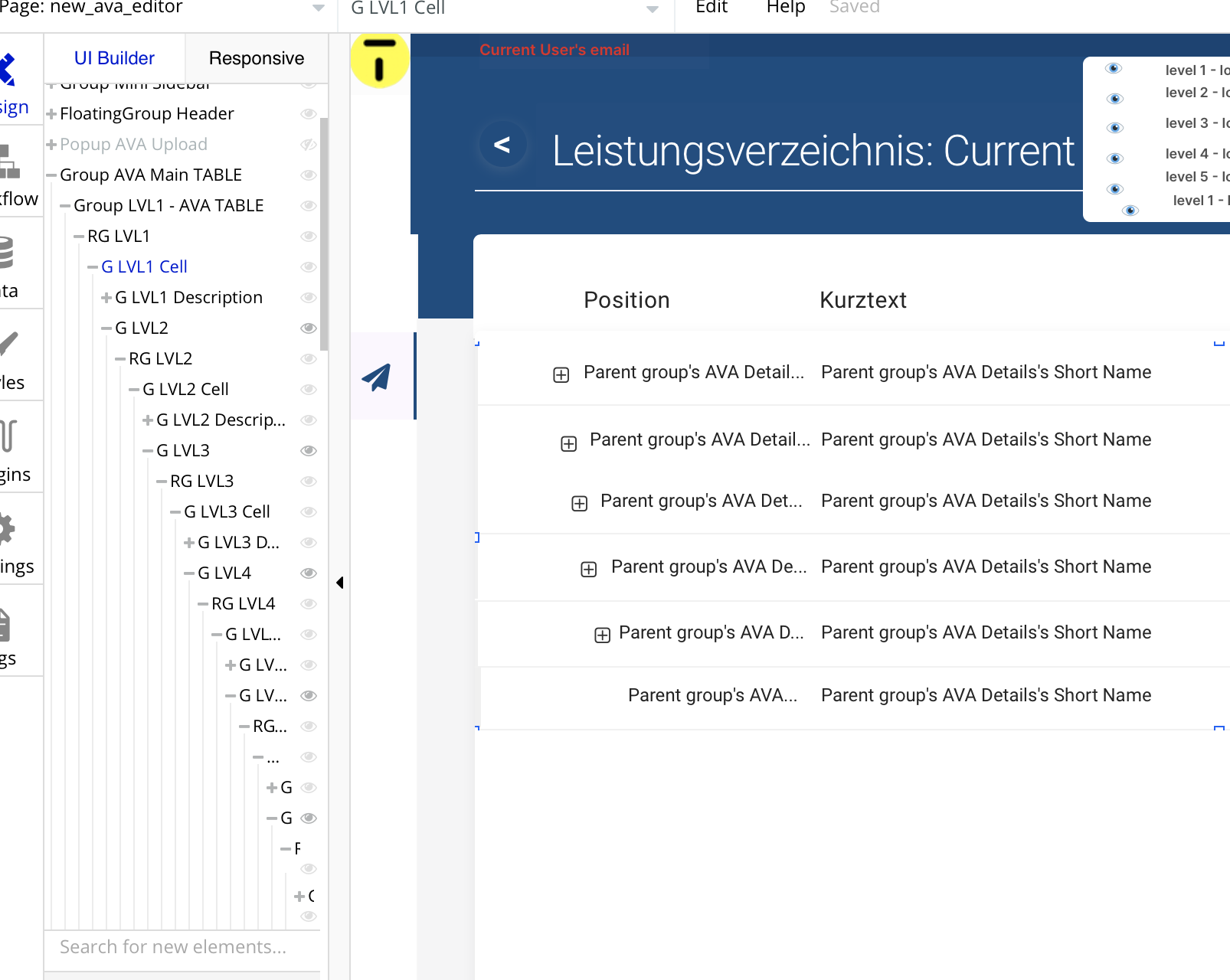

Hi - just testing the Plugin - idea is fuckin awesome - was looking for this for ages!!!
Question: Will it also “get through” if I have not a text in my nested RG2 - but text inside couple of Groups… I have quite a large 6 Level structure - is this causing a Problem? Not working as of now…

Thanks for checking out the plugin. I’ve had a look at the clip you sent of the issue and your setup should work. I tried recreating your setup but the plugin still worked for me. Could you consider the following:
  1. Does the plugin work if you try a very basic example somewhere in your app? Just so we can rule out an issue with the installation.
  2. Are all parent groups of your RG and the text element set to visible on load, including the text itself?
  3. Can you ensure there are no other elements using the “R” or “text” IDs. You may need to use your browsers console window to search this. Or else just change the name to something unlikely to be in use already.
I’ve pushed a small update to the plugin which includes console logs which can help us debug further if the above does not resolve. Could you update the plugin and send a screenshot of the console window after your page has loaded?

Hi - re2: Is visible at load a must? Its designed ina way " when RG have >0 elements they are visible - but not always. Some Docs do not have all Levels only 2-3 or so…
Is this a problem? But when they load data they should be visible so?!
The plugin grabs the first cell of the RG, so as long as that does become visible. From your example it does look like all the cell rows are expanded so it should work.
Can you PM me the console logs please, and provide a link to your app (not the editor, just the run mode)
