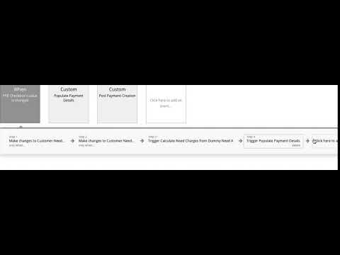

I am getting frustrated on how many times Bubble stops showing the little pop-up editor that is there for each step in the workflows where we define what to do, to which element etc. It stops showing randomly, and starts showing again randomly when I move around to some other tabs and come back. But often it just doesn’t come back and I need to restart browser etc.
Has anyone else experienced it? Any solution? (Apart from clearing cookies, restarting browser etc, as I tried those and they work, but how many times can I keep doing that?)
Here’s a video to explain what I am seeing.

I have also experienced this problem before. Try reloading page or closing the browser and opening the internet browser again. Also, if you have a lot of tabs open, try closing them.
In my case, I think the problem was related to a lack of computer memory to properly load the Bubble editor, the Bubble app editor can require a lot of memory especially once an app has lots of elements and workflows on the page
Yeah, that does happen often, I do think it is a bug. Maybe @eve can send a note to the developers and show them the video.
A temporary fix is to just double click on a workflow instead of a step. Then click on the step again. It will show after that. No need to refresh the browser each time.

Yeah this happens all the time. If you click a different top level workflow and then click back it will work again. It’s a bit of a pain, but there are so -so- many of these GUI bugs in bubble that I’ve just learned to live with it, and focus my time on developing instead. I know that’s not good, but hey, at some point I don’t want to be a professional bug tester either :slight_smile:
