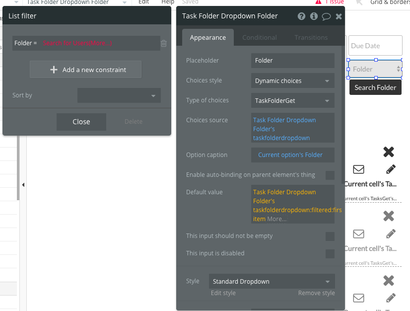

Hi @bkhoward2001 - if I’m following your issue, I had a similar issue with getting a default value for a dropdown that was fetching from an API call (though not in a RG). To solve it, I needed to do an API call in the “Default value” field, then do a filter on the returned values (which also included doing a Search within the Filter - see pic below and the text in red).
Not sure if this helps or not but for my app, doing this allowed me to have Default value populated with correct data. Initially i was reading data from data record but that didn’t work.
I am not sure I am following this… what would be the filter criteria in red?
In my case, I have many Users and a Custom Data Type that stores API info for each User. So while I do save the API data in the Custom Data Type (I save one piece or “line” of data from a list of data from the API call) for each respective User, the Dropdown didn’t work.
By this I mean I couldn’t show the Current User’s data from the Custom Data Type in the Dropdown.
I don’t recall the error exactly but the Default Value in the Dropdown was expecting the same Data Type as “Choices source” (which is the API call type and not “Text” like the data field is in the Custom Data Type). As such, the Dropdown wouldn’t show the database value from the Custom Date Type for that specific User.
To fix the issue, I do an API call in the Default value field. If I don’t add the :filter, I get all of the data from the API call. In the filter, I have the API URL Parameter Key equal to a Search value (what you see in red). In the Search I use other data fields from the Custom Data Type to find the Custom Data Type instance for that particular User. Then the data field from the search result should be set equal to API URL Parameter Key (similar to what you see in the Filter’s constraint line above)
In your case, it sounds like you’re getting a full dump of data from the API call. If you do an API call in the Default value field and put a criteria to constrain the value, it may solve your issue. But I’m not familiar enough with your app to know what to do a Search on (again my search is for a Custom Data Type, not User as shown in red). Based on what you have shown for Choices source and Option caption, It does appear that you want a Filter constraint that would be “Folder = Search for xxxx”.
Hopefully that helps clarify and not confuse.

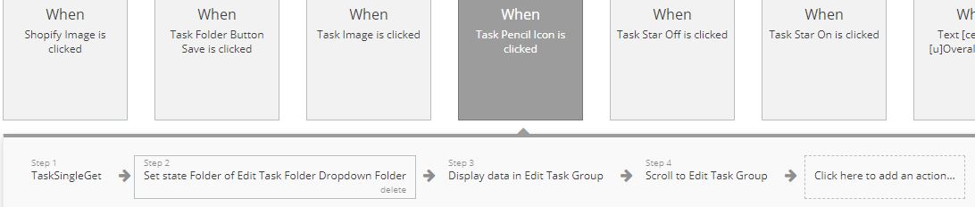

  1. you click on a task in the repeating group using the pencil icon.
  2. The fields from that particular record in the repeating group are brought into the edit area at the bottom of the screen.
  3. The dropdown at the bottom of the screen contains the correct folder from the repeating group record.

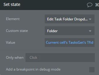

I’ve altered the example to make it work, in summary:
  • Assumes no duplicate folder names for the user.
  • Changed the dropdown type to “text”, this allowed it to use the default value (folder name).
  • Altered the dropdown’s data source, etc. to get folder name instead of folder.
  • Altered the update record to lookup the folder’s id from the chosen folder name.
  • Added a step to clear(reset) the dropdown’s parent group on pressing the pencil button, this clears any manually changed dropdown value.
  • In the filter, added a criteria to check for empty choice, as a workaround for it showing the first of all options if none is chosen.
