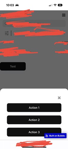

I’m trying to replicate the following design and behaviour with a popup (fixed to bottom of screen, full width):
I can get the transition to work, and the width (using a condition with 'Current page width <= bla), but I’m not sure how I can get it to stick to the bottom?

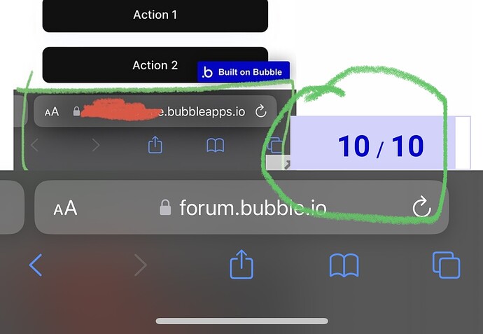

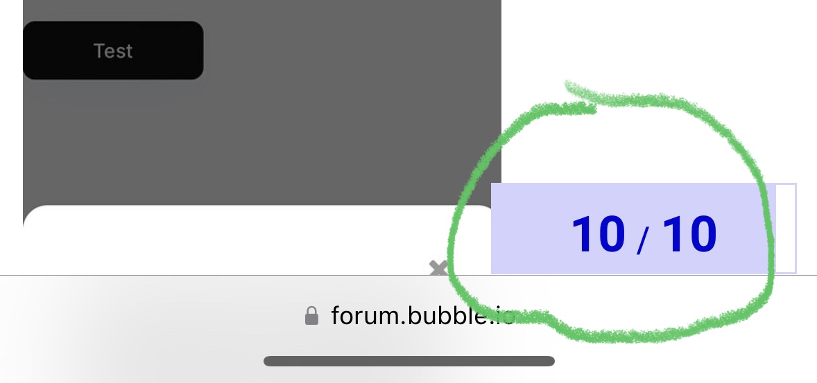

Also, I’ve just realised this might not work due to how browsers work on mobile…
In the example below, you can see the web page actually loads behind part of the browser ui (in the green box i’ve drawn)
I might have to look at a floating group somehow - I can see in this forum bubble manages to have a group pinned to the very bottom, which stays relative to the ui as it grows and shrinks
