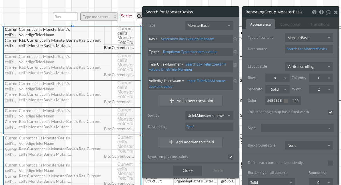

  1. A screenshot of your setup. (capturing your inputs & repeating group)
  2. A screenshot of your selection workflow.
Just to confirm: Your inputs values are not empty after selection, right?

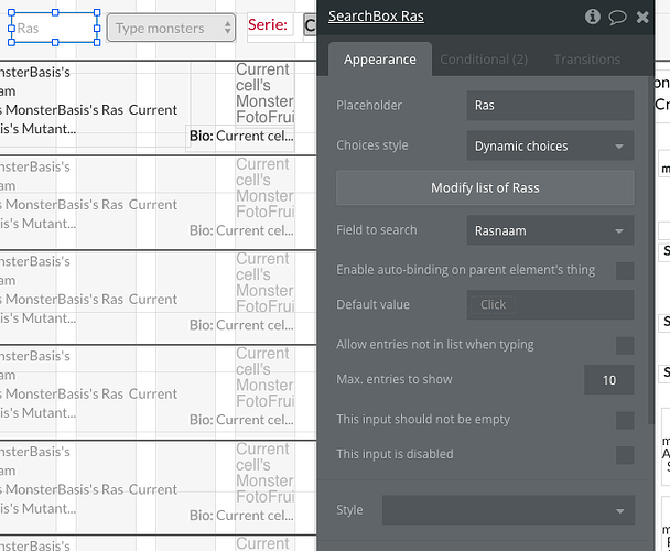

Searchbox “Ras”:
Repeating Group

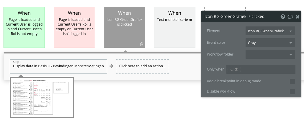

Icon workflow that sends data from the RG item to the group

To 1. I could not recreate your example (where your inputs would reset themselves upon selection of a sample). I am guessing that you have some workflow that (when page is loaded or some element close to your selection icon has a workflow that resets data.)

Hmm If I enter a variety name in the search box “Ras” this field will be deleted after selecting 1 of the fields in the RGroup.
How can I stop deleting this so that my selection will be intact after selecting 1 of the samples within that selection?
