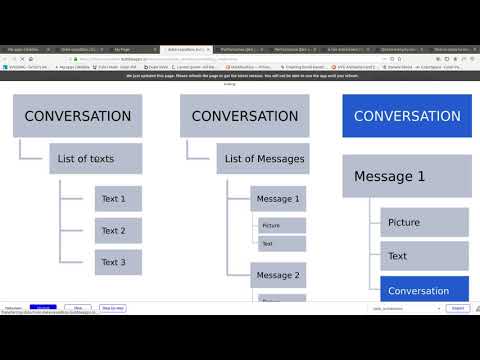

You should make a conversation type, and a message type linked to the conversation. If you only need 1:1 conversations, you method works. If you ever need group chat, or if you want to remove the :merge and :sort operations from happening in real time, you can apply this data structure very easily. Here is a short video I made a while back discussing it:
@duke.severn 's approach seems much better. But like he shows your data structure for chat seems a little off.
