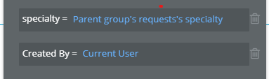

I have a table ‘Requests’ with a field called Specialty. I have a repeating group that searches’ Requests and displays all the Requests’ records. What I want is that the repeating group shows the cells ie records from the table Requests that have the following constraint:
Specialty = Parent group’s requests’s specialty OR Created By = Current User
The Constraints in the repeating group when I do Search for requests are always AND constraints
Any way to do it?

Hi there, @abalgir… one way to go about it is to use the :merge with option. So, do a search with the first constraint, and then merge that search with a search that has the current user constraint. Make sense?
Hope this helps.

Hi Mike,
Thank you for this prompt response. It worked like a charm ! :ok_hand:
