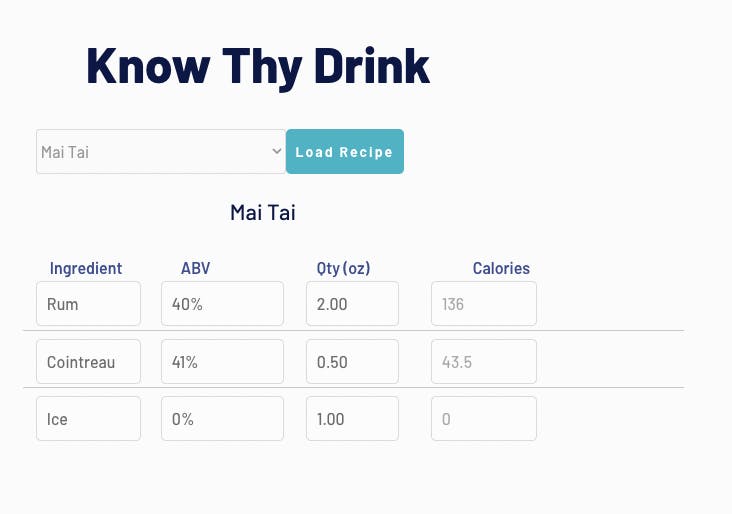

I have a repeating group that lists the ingredients of a recipe, along with quantity and unit. Ingredients are their own data type, while qty / unit are columns within the recipe type.
I have the trashcan set to set custom state, minus item current cell’s ingredient - this successfully removes that row’s ingredient and attributes tied to that ingredient (such as calories). It doesn’t however remove the rest of the row on the repeating group. I tried setting another custom state just for ‘Qty’, but when I remove ‘current cell’s index’ it instead removes any quantity value matching that cell’s index (so if I click ‘trashcan’ on line 2, it removes any line’s quantity with a qty value of 2).
Is there a different way I should approach this? Is there a way to simply remove an entire row of a repeating group regardless of data type?

A recipe type is comprised of a list of ingredients type, and then the Qty & Unit. That tie to ingredients is what pulls in each ingredient’s Calories, ABV, etc.
Yes I did try this, and while it sort-of worked as I mentioned in the original post, the problem I encountered was the ‘Current Cell’s Index’ was removing any Quantity with a value of that index. So if I clicked the trashcan on line 2, it would remove any quantity of 2oz.
Understood on both of these - I hope my details about how I structured the Recipe type in the database clarifies this - any reason my existing structure wouldn’t work as-is? I believe what you’re referring to (creating a 3rd thing known as Recipe items) is known as a ‘junction table’, although I had been led to believe bubble didn’t require junction tables as linking one type to another, it does the work for you.
Thank you for sharing the db screenshot. The issue is that in the db ingredients QTY and other items do not have a link to each other. Relating them on the basis of #index works but only takes you so far. It will not only create problems ahead but also make the calculations much more difficult for even the smallest tasks (like the issue in this post). Having a dedicated thing for each set not only makes it easier to implement logic, but also takes the complexity out of the data storage and processing.
This could happen if you are using “:Minus item Page content’s Recipe’s Qty:item #Current Cell’s Index’s Value”. Since this translate to a string so Bubble will delete all the text entries matching that text.
I was finally able to wrap my mind around this and made some changes to the DB, creating a new data type called ‘Recipe-Ingredient’ which is an Ingredient, fields for Qty, Unit, and Name. I re-worked all of the sandbox recipes I’m using into it, and re-wrote the repeating group to reference a recipe’s ‘recipe ingredients’ instead. It works flawlessly, and I really appreciate you pointing me in the right direction-
