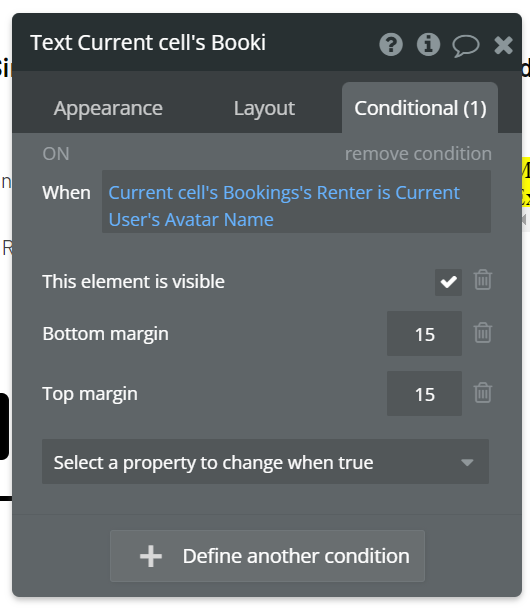

Just tried to add a conditional format to hide the element when Renter <> Current User Name, but that didn’t seem to work.
For some reason I can change the text, but I cannot hide the results.
Not sure if this is the best way to do it, but it seems to give me what I am looking for. Basically, I set it up to pull the whole list, but made the list invisible on page load. And then using conditional formatting, I conducted the search and for the “true” results, made them visible. If anyone has a better way to do it, more than happy to try.
The constraint Renter = Ccurrent User's Avatar Name
have to be within the repeating group data source which is search for Bokings
Perfect and much more simple. Didn’t even occur to me to do the search in the group itself, rather than every individual text box. Thank you!!
