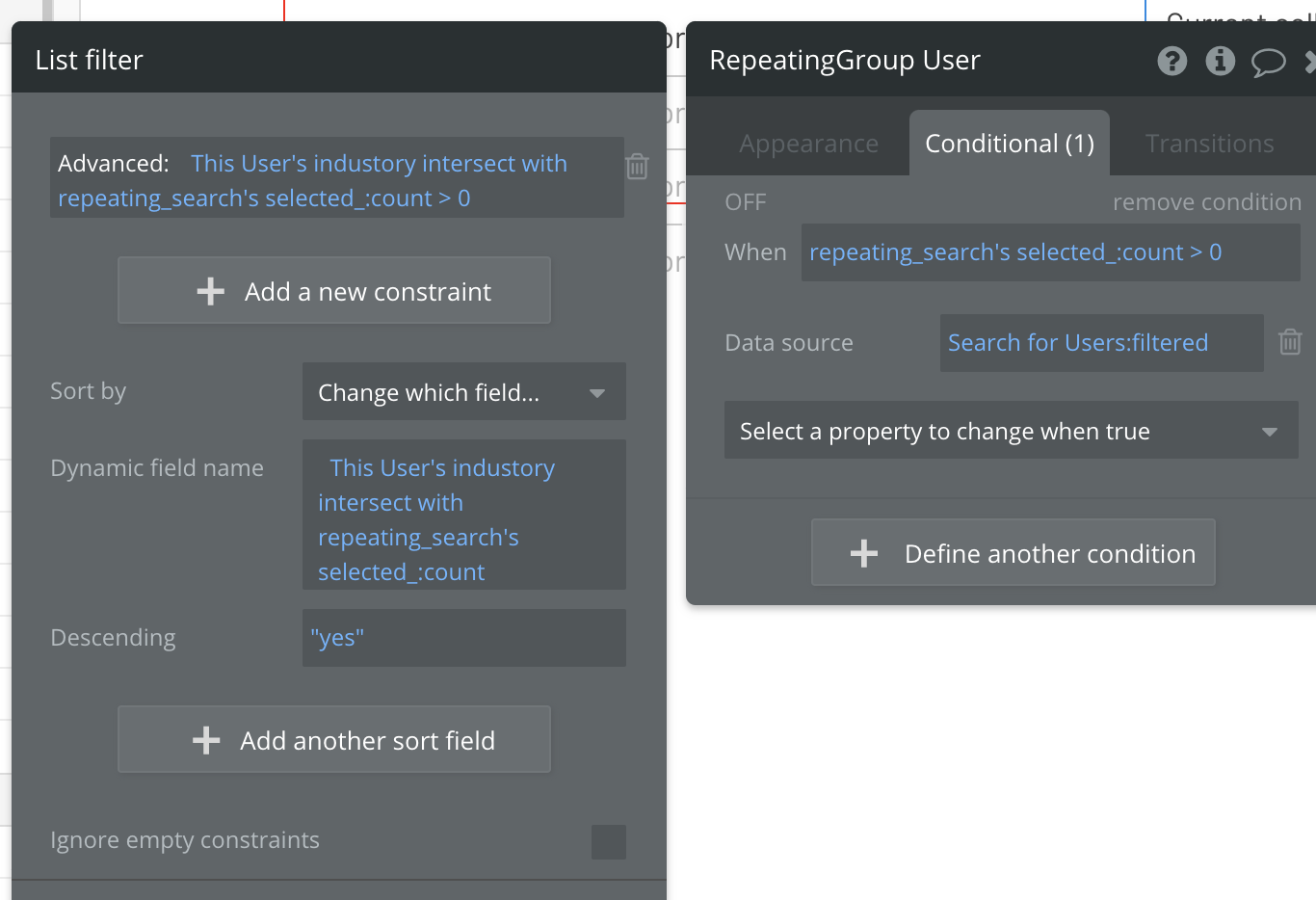

hi @romanmg
I made a user’s repeating group which has field of list of insutory.
I want to sort this repeating data by the rule of how many industories overwrapp with the custom state. (see below)
I cannot get the result I expect.
Do you have any advise for me ?
Thank you
