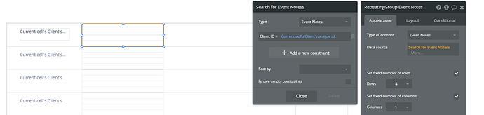

How to set conditions for not show every cell in RG-2 inside onely the cell that belong to RG-1 cell ? this i hard for me
No one ?
Can’t understand the problem. So you have nested RG. RG-A of data type A and RG-B of data type B. Data type B ic connected with data type B. For each thing in RG-A you’d like to display a list of related B things in RG-B?
It 2 different data types, in the same group…
Not sure I fully understand the question, but perhaps all you need to do is add a constraint to the second repeating group search that it will bring back only the records related to the current cell of the first repeating group.
