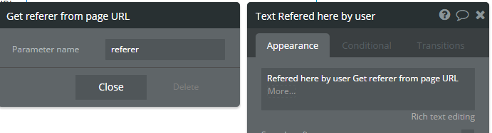

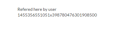

The landing page then pulls this out.
You can then run something on page load to store this. But I just put it in a text box.
This is how we can send a bubble id via any channel on a url, and pull it back.
You would need to search for the user like this …
You need :firstitem to force bubble to think it is a single row. otherwise you get an error.
