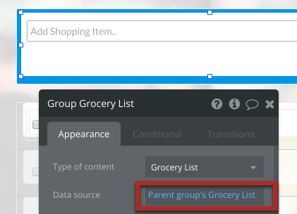

I assume this happens when the Add Item button is clicked. I can see that you are creating a shopping item and setting its list to the parent’ group’s shopping list. I see you are also adding the new shopping item to the items list on the parent group’s grocery list. This all looks fine to me.
It’s difficult to understand the exact flow, without knowing what your app is trying to do, but I did notice that you have two groups called “Group Grocery List” and only one of them has a data source specified. Try naming them differently to avoid confusion and also try setting the outer one of the two to also have a data source of parent group’s grocery list - unless you’re dynamically setting it in a workflow (I couldn’t tell if you’re doing so or not).
If this doesn’t work, then I think you would need to explain here the flow of your app. I see a lot of references to inviter and invitee and their grocery lists but it’s not clear to me how it all works. With a bit more of an explanation, I, or others may be able to assist further.

Okay, seems straightforward enough. Like I stated, I see that at step 3, you are correctly assigning a grocery list to an item as you add it and vice versa. The grocery list you’re assigning in the ‘parent group’s grocery list’. In other words, the grocery list of Group Grocery List.
I think the issue might be that the group shown below (i.e. the outer ‘Group Grocery List’) does not have a data source set.
Try setting it to Parent group’s Grocery List like you’ve done for the inner group below:

I think I see another potential problem. Your ‘shape C’ is obstructing the text box (Text current cell’s Grocery List), so whilst the text box has a workflow step that sends data to the shopping items group, the step is never actually triggered. In other words I think your workflow for Shape C is getting in the way of your workflow for the text box. You need the latter to run in order to pass the current grocery list to the shopping items group.
To resolve this, either remove or send shape C to the back, or add a workflow step to its on_click event:
I hope this resolves the problem.
