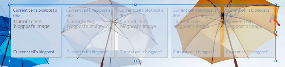

Here is an example. I have a list of Blogposts on a page as a repeating group. The page has no Type, despite it being about Blogposts. It is linked to from a main menu, so doesn’t need to send anything.
When you click on one an action takes you to an edit page for THAT blog post. So I am sending the thing I have clicked on…
And the page is set up around dealing with a SINGLE blogpost.

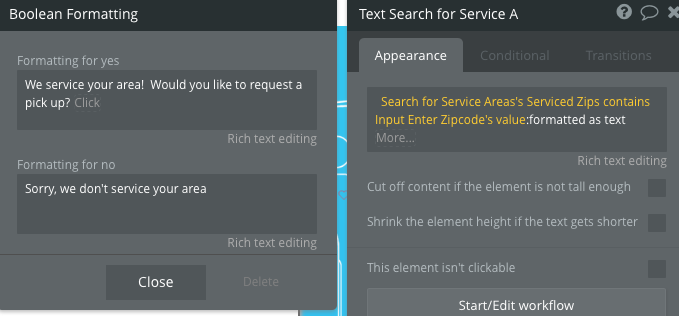

I have a question about linking. I am attempting to do conditional linking based on a boolean result. I have all the workflows and searches working correctly. However, in the window ‘format as text’ which allows me to edit the different results, links can only be entered in rich text.
So the question is, how do I get a link to a sign up page (which is already created), if the zip code checker returns a positive result?
Then, if it returns a negative result, display a request to sign up to an email list for updates?

I am not sure that I understand, or that I am missing something. After clicking the ‘rich text’ link found below the ‘yes’ field here:

Right, you need to do this in two steps. You fist type a URL there manually, and then once the BBCode is generated you can replace the static URL by a dynamic one.
Oh! That makes so much sense, thank you. Also didn’t realize that was a possibility or needed that kind of work around.
