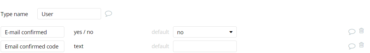

  1. Add two data types, ‘email confirmed, yes/no’, ‘email confirmation code., text’.

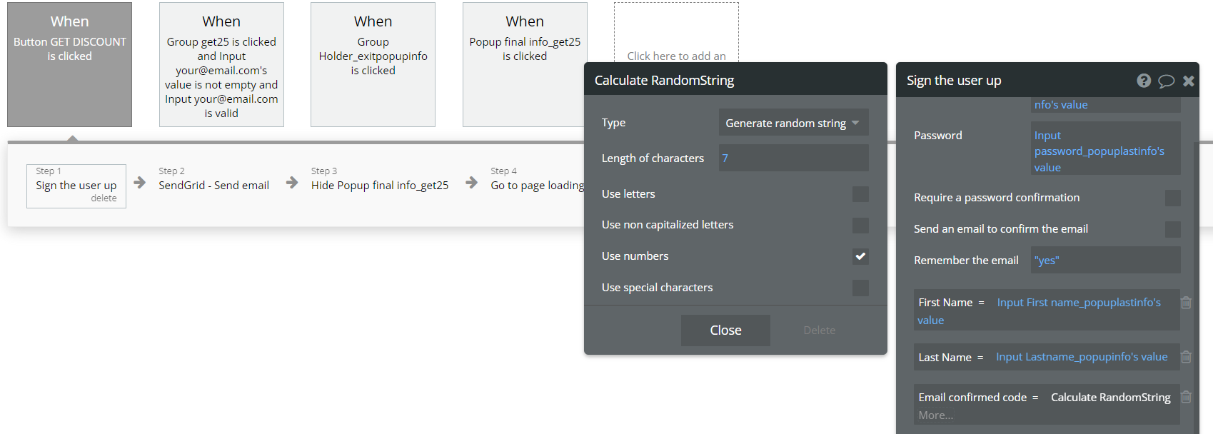

  2. When signing up the user, Email confirmed code: create a random string of how many characters you want.

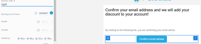

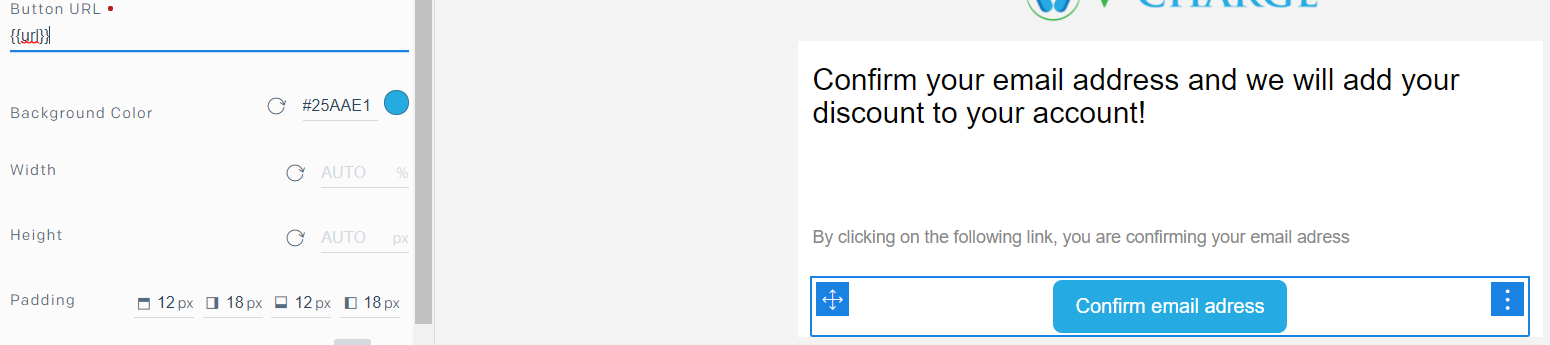

3b) Go over to SendGrid and put in the Button URL: {{anynameyouwant}} for convenience purposes I just use ‘url’. With other email services, you need to figure out this part on your own but it probably be pretty similar, quick google search and you will find out
3c) On the Bubbleside add an action by sending an email through your email service, then create a new key with the same name as {{anynameyouwant}}. As value put in your confirmation linkpage&code=Email confirmation code.

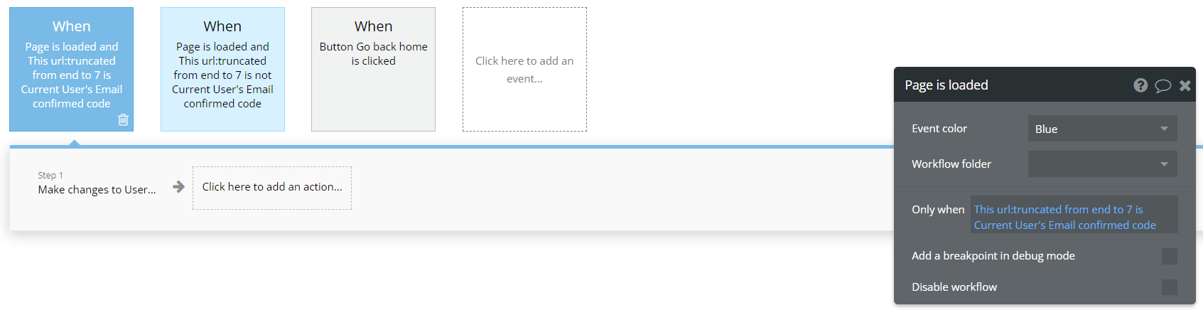

4a) When clicking on the email it will take you to the confirmation page, on the confirmation page workflow do the following truncate to the end to the number of characters you wanted in your random generated string, I have 7:
(if you have more data to send through your url you can also use extract with Regex instead of truncated)
4b) When the confirmation code of the current user matches with the confirmation code in the link, change the email confirmed to ‘yes’ and redirect them to the home page.
