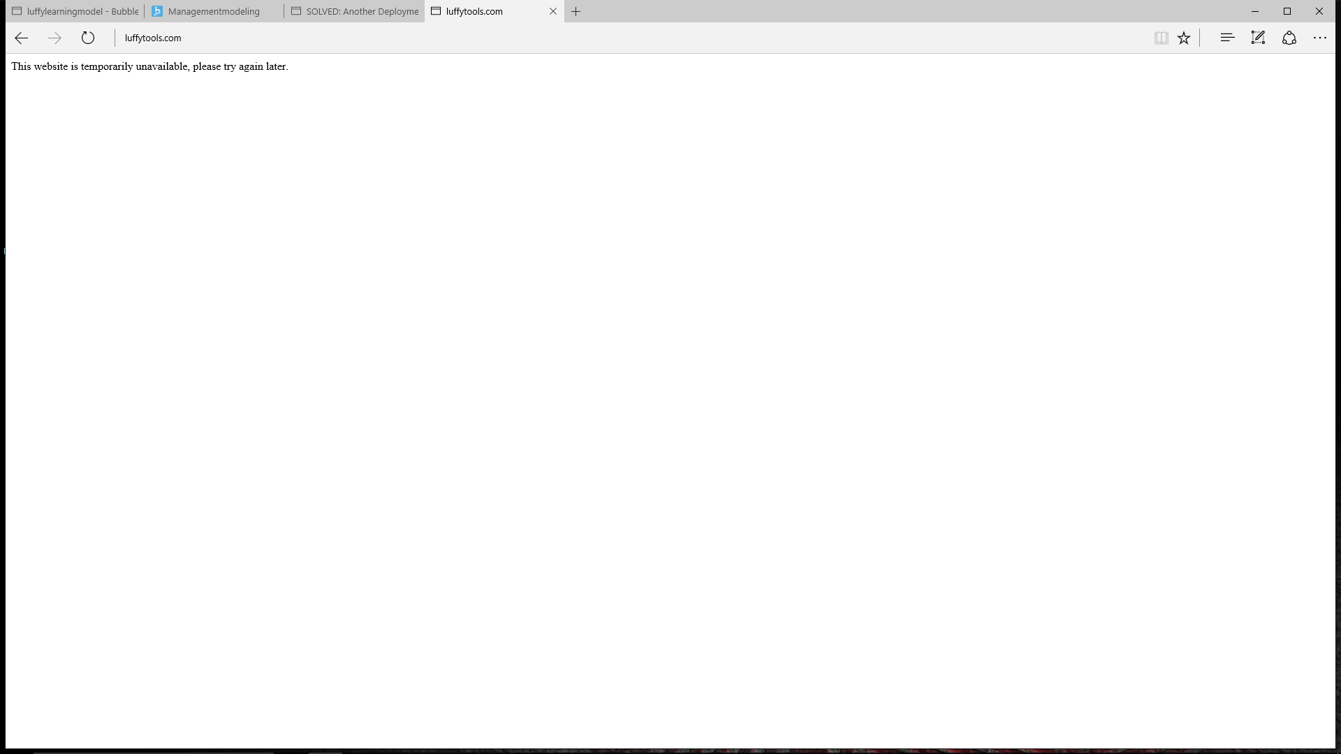

So I made my first attempt to deploy to live. It did not go well. The browser froze up and then it just stayed frozen. Not sure if I did it incorrectly. I am back to development and it says I never deployed to live. I have read the documentation so I feel like I am missing a step. The app works great in development preview but won’t even load in live. I have not figured out how to set a starting page for the app yet. Could that be it? Does the app always start from the default index page?
Ok it is working so long as I manually enter the first page after the x.com/ backslash
So if I enter x.com/start_page the app works great. Question is how do I set it up so when I go to x.com the site automatically takes me to x.com/start_page
Got it. That was a real NOOB thing. Had to set up forwarding in my Godaddy account. Never done that before:)

Ok that is why I wanted the forwarding so when someone went to www.luffytools.com they would actually go to www.luffytools.com/start_page
Ashley -
Okay; but that would actually need to be done on the hosting side as a server redirect. Because your host is requiring you to point your A Record to them; forwarding from our side isn’t going to work.
Yes, the way to do this is more by replacing index in your app.
That does not seem to work at all. I made start_page my new index, deployed it, and when I go to Luffytools.com it is still taking me to a blank page.
have you deployed to live?
Yes. You can see it at Luffytools.com
If I put in www.luffytools.com/start_page it works fine
I just fixed something, if you deploy again you should be good.
Working like a charm. Was it something I did that caused the initial problem?
