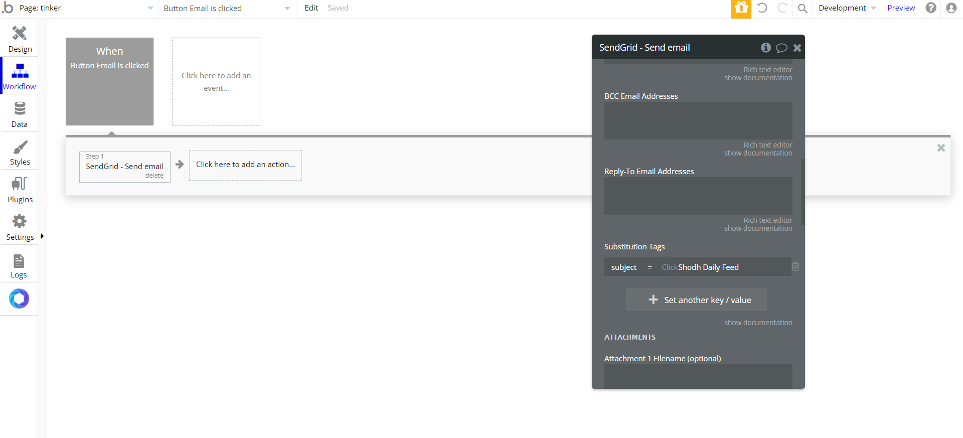

There’s not much more info than I had put above, the send email action is this;
The only thing which isn’t showing is that the email is sent to Current User’s Email.

I have the emails working now, the issue was in how I formatted the emails. This is the correct way to make it work for anyone struggling;
format
