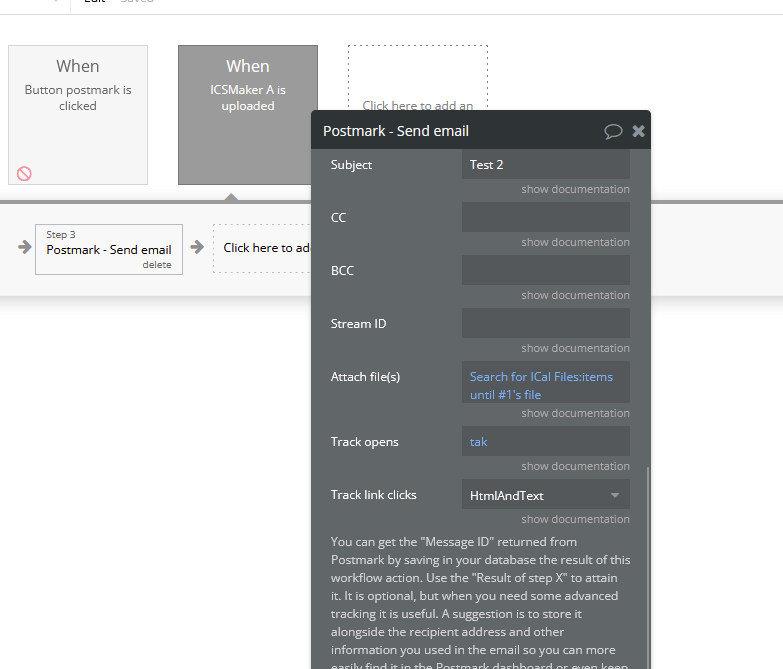

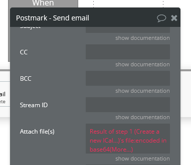

I have two and in both I have a problem how to attach it:
Step 1 (File has been created and I have it in table “ICal File” in column “file” type “file”
and I would like attach it to postmark mail:
first pluggin:
second:
OK, it works
Attach file(s) field needs list of files (not one file), so we should use “:items until#1” instead “:first item”
First test has been finished with success and Postmark send email with invitation (ics file), so it looks like solution. I will implement it to my solution and I will check the percentage of emails reaching the target.
