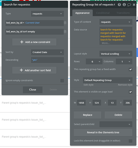

My repeating group with 1st search

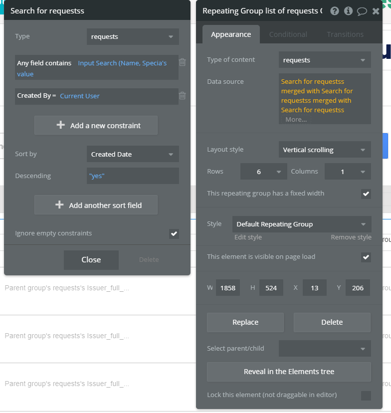

My repeating group with second merged search

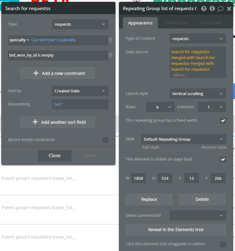

My repeating group with 3rd merged search

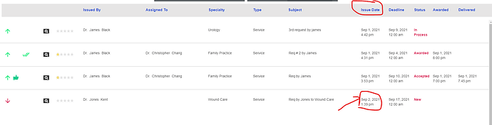

The result of the repeating group remains the same whatever sort order I apply
Hi!
This is because you are doing 3 different searches and ordering them independently. To order the entire result of your 3 merges, try to add the code below in the end of your merges
:sortered
Many thanks. It worked. I appreciate your prompt assistance. :ok_hand:
