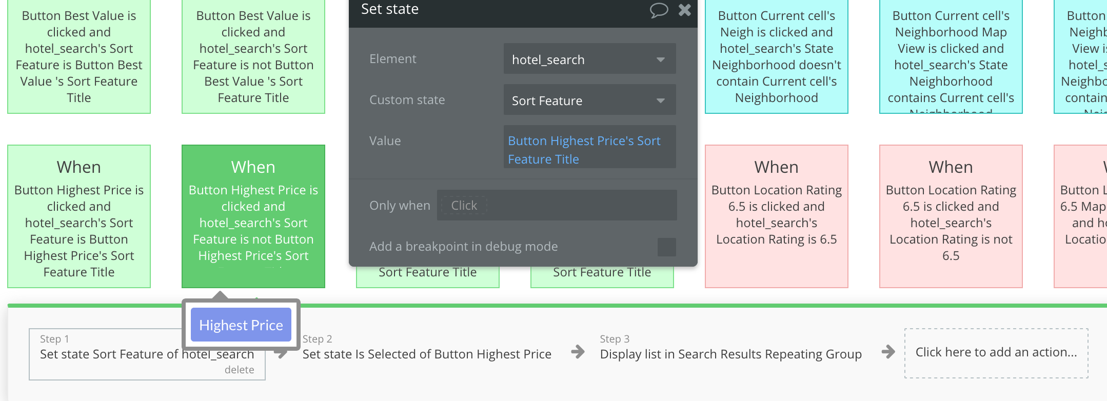

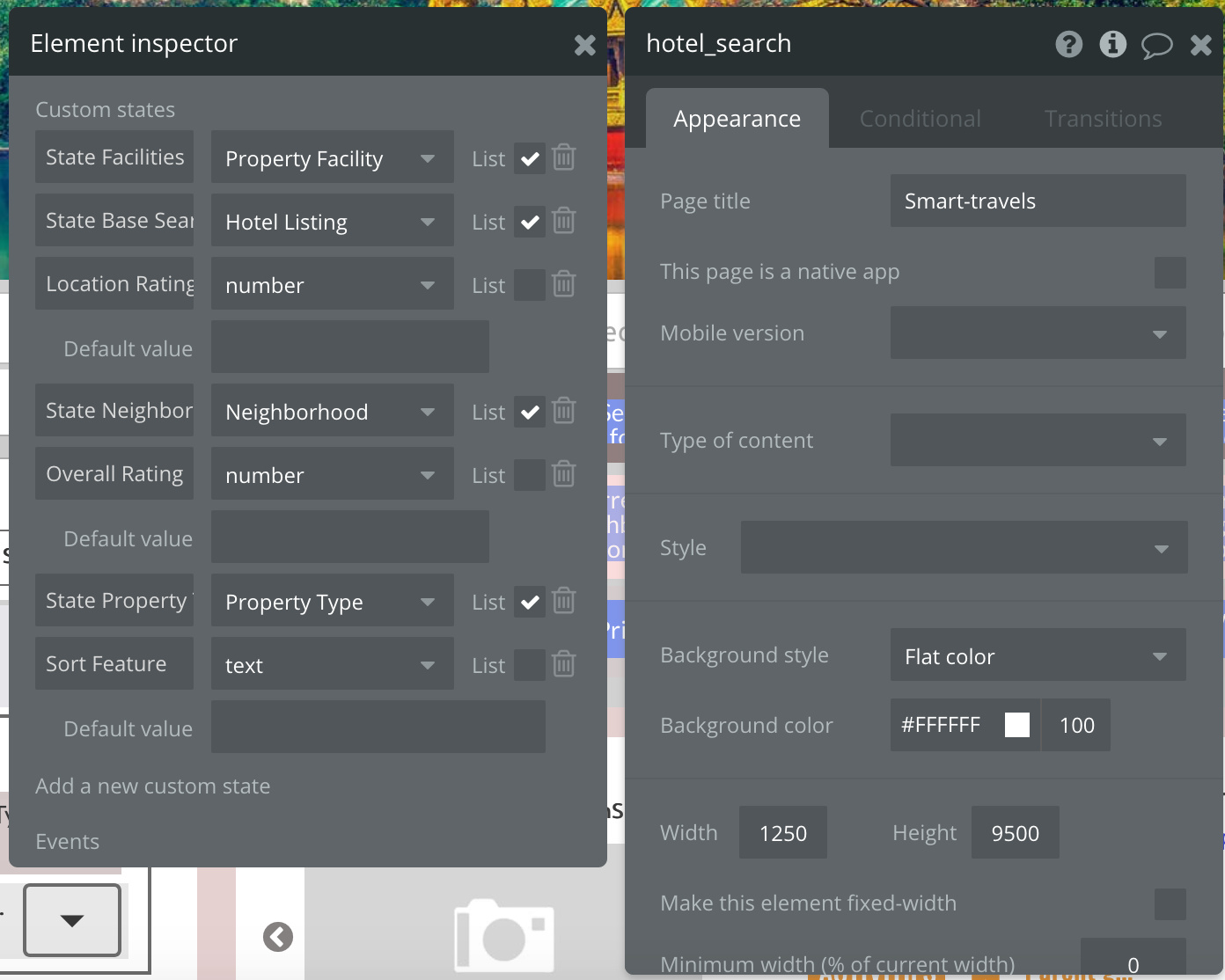

On the page (hotel_search) there are various custom states. One of which is sort feature as a text item.
In the workflow I have the custom state being set when a sort parameter is clicked.
The above custom state set on the button element of the sort parameter on the page is:

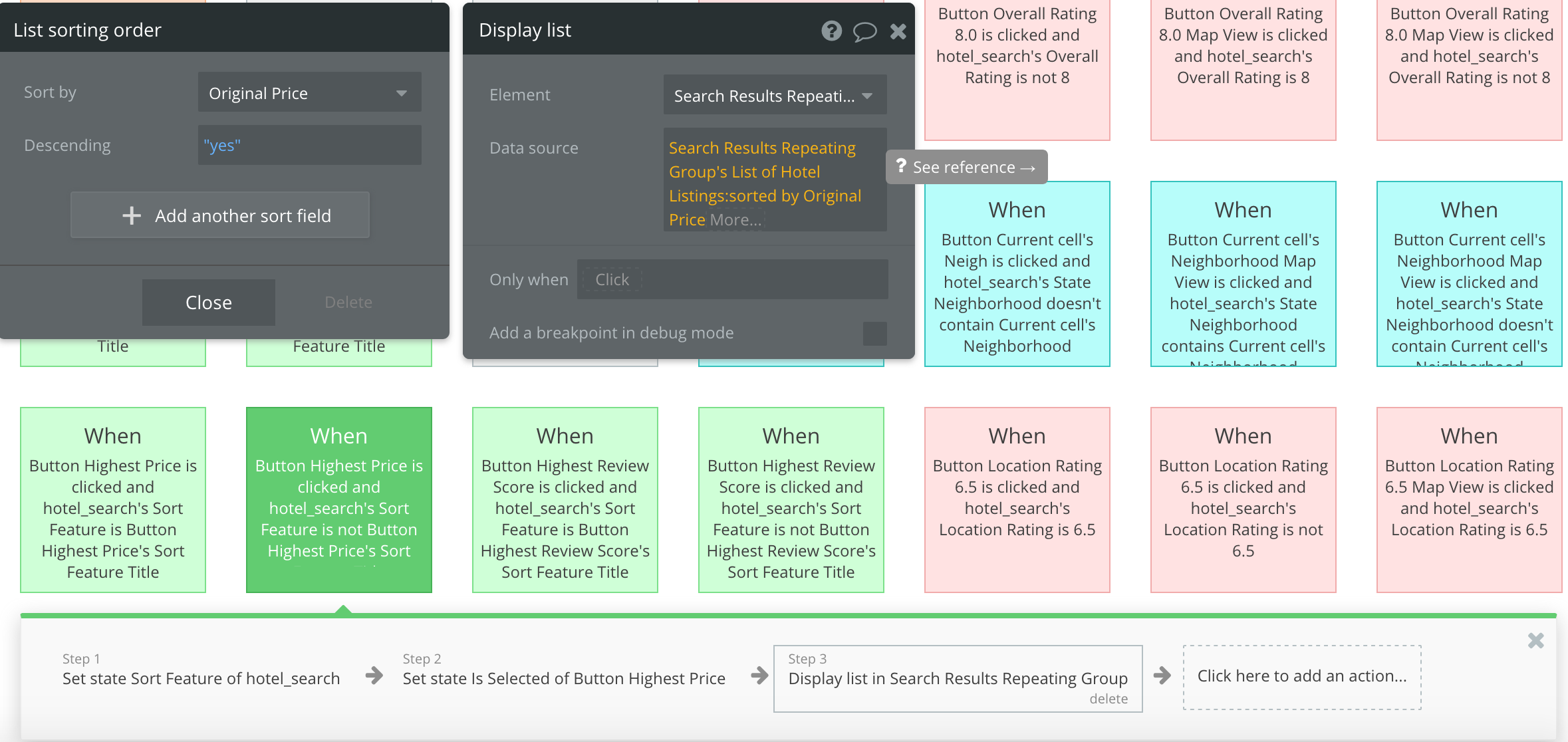

Then I have the search results repeating group data displayed set in the workflow:
Also in the workflow I have actions for when the sort parameter button is clicked on page and the parameter is already the value listed on the hotel_search page’s custom state
SO, my basic logic was to use a workflow to set the display of the repeating group search results to sort by the hotel_search’s sort feature’s value ( equal to the value of the button selected as a sort feature ).

NOW, turn on step-by-step and click a search constraint button like “stars”. At the end of that workflow, you do THIS (display list):
At that point, your list in the RG is now “fixed”.
