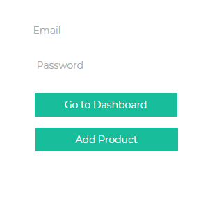

I have a very basic page, with just two inputs and two buttons. See screenshot below:
There is no conditional formatting of any kind on the page and the page uses in-built Bubble elements (input and button).

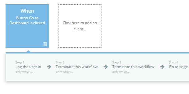

There is only 1 workflow, which logs users in and redirects them. See below:

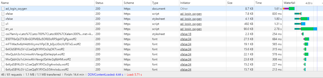

But my page load time for this page is 4-5 seconds on average (and obvioulsy with more complex pages it is significantly more). See the network waterfall from chrome dev tools below for this page:
It seems that the basic bubble elements like xfalse, x1, en_us are responsible for high loading time. How can I get the DOMcontentload time to around 1 second for a page like this?

Where are you based? What’s your internet speed? That load time seems reeeeeeeeally bad. I don’t see similar results. Can you share a link to the version-test so we can test it?
Also try a Capacity Boost once just for fun in your settings page, just to see.

No, can’t recreate it either. Loads OK.
@t_bubble that page loaded mega fast for me. I’m in Washington DC on a 150mbps connection, for reference.
I certainly encounter Bubble pages that load really slow, but that’s usually because the builder didn’t optimize images or searches. In your case, I’m not sure why it would load slow, as it was almost instantaneous for me.

I reduced the size of the xfalse JS - from 90KB to 49KB by removing a bunch of unused plugins - that seems to have helped with the 1st page load time.
