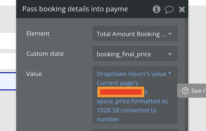

Thanks guys. So I got the idea to format the formula I have in the custom state to add 2 decimals and convert it to a number as in the pic.
I am using the value stored in that custom state in the picture in the stripejs plugin for payments.
I have to mention that custom state field type was set as number.

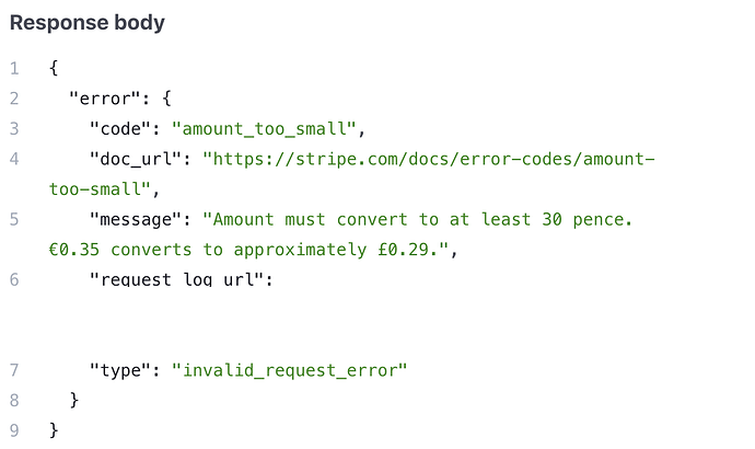

DIviding it by /100 works for JPY. However, the formula in the custom state will be in place for all currencies, and when I do a payment in euros, based on the same state, it says it’s too small, as in the pic below. So for example a payment of 35 euros, will arrive in Stripe as €0.35 because it’s been dividing by 100.

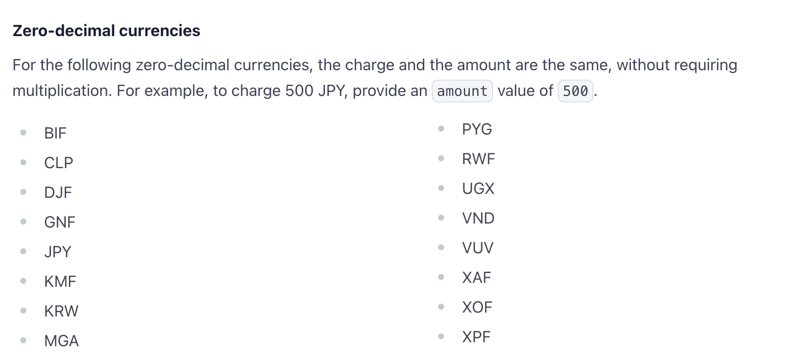

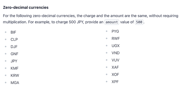

I also found the below on the Stripe payment documentation. I find it hard to understand and fix it:
Indeed… the Stripe docs state exactly what I’ve already been saying…
