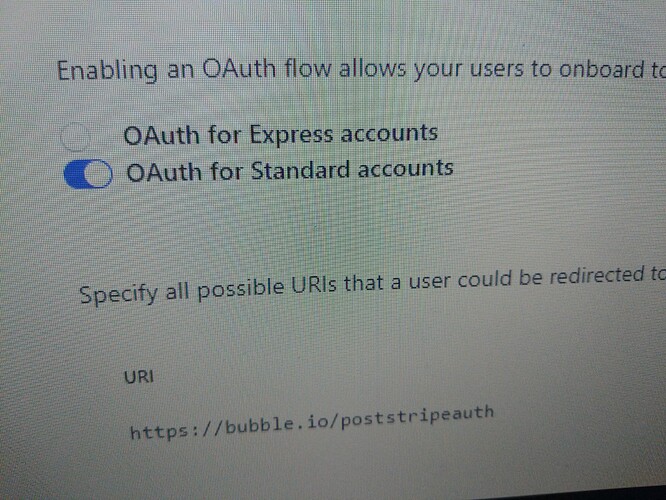

It appears to work. Reading the documentation you would think that replacing bubble.io with your domain would be the correct step in adding the URI. It is not. Add the URI of https://bubble.io/poststripauth and bubble will do the rest and return your user to the page they started on. Good luck To test it, put this in the URI https: //bubble.io/version-test/poststripeauth (note: remove any spaces in my url) if you try posting in the forum with no spaces it looks like this Stripe Authentication

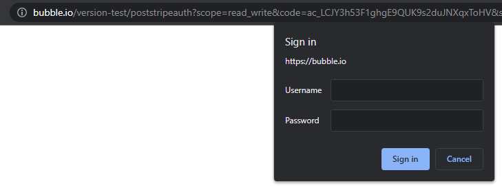

It wants me to sign into bubble !
Something changed. I kept getting the same error and had to rework the call. If I remember correctly it was something weird, like you don’t need to include version-test. I lost my mind about a month ago but got it working again. — edit: I think I remember having to check and alter the redirect URI in stripe… I knew I should have written that down.

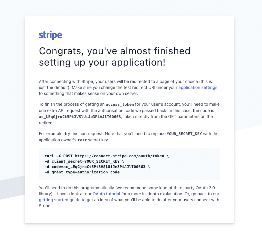

Doing it manually now (grab the code and do the token swap. Works… but surely Bubble should do this for you? That is what the docs say.

Just checked my settings. That’s the same for version test and live.
When I do that … it goes to bubble and asks me for user/password

I keep getting this and I have all the relevant URI’s in Stripe
Aha… more fun. So when you run in LIVE Stripe … it works with the Stripe Authentication
But not in test.
Which makes things fairly tricky.
Works in Live but not Dev.
Rather than wait for Bubble I run a workflow on page load that checks for poststripeauth in the URL and then grabs the code from the URL … and does the token exchange you posted above.
This then gets me the Stripe Key which I store. Not great security, but can’t have two different ways of working across Live and Dev.
