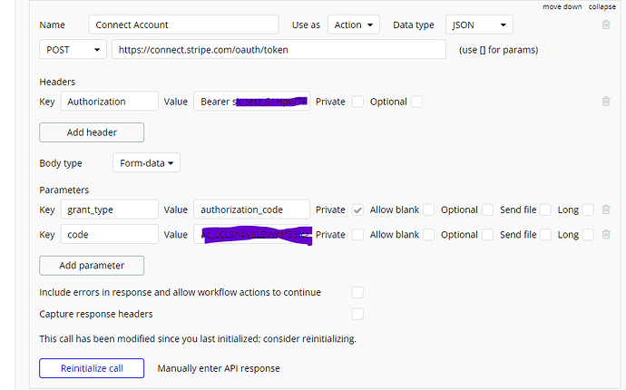

Take the code in the URL when you return from Stripe. Swap for for Token. Store.
This is only because in test mode I have to use
my domain /version-test/my page/poststripeauth as the redirect.
In this case Bubble does nothing itself, but I can get back to page I was on, and know I came from stripe so can process the token, and do a page redirect so we are back where we started (in this case, the page has a page data type, so I need to look it up again - although stripe does give the calling page back to you which is probably a better way come to think of it).
