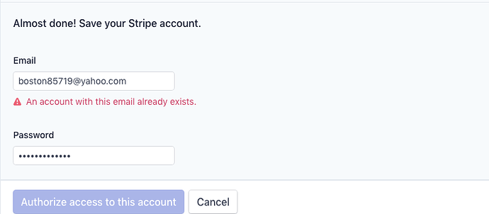

When I fill out the form but use my existing stripe account email and password I get this error message
and see no way of signaling to use that account instead of creating a new one.

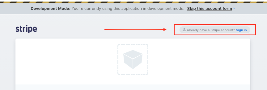

Okay, so I have finally found this “Already Have an Account Login” at the top right in tiny little letters
Clicked it, signed in, but the entire form was still required to fill in! Why? Wouldn’t logging into an existing account fill the form with all information from that account and enable the Authorize this account button to be pressed?
